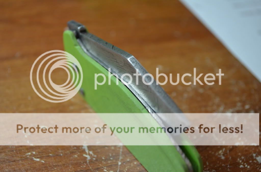

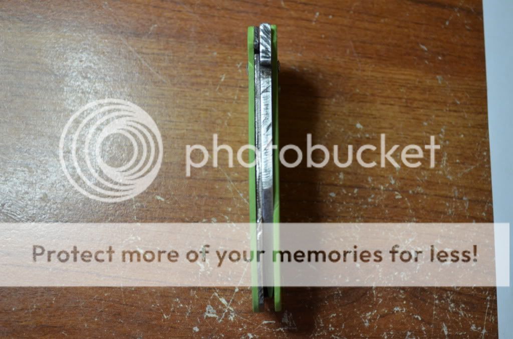

I just "finished" my first liner lock. The only problem is, the blade won't open. It's wedged closed between the titanium liner and the scales. I can push it open from the other side- there's no backspacer, just standoffs, but I can't open the blade normally, it just wedges itself in between the two sides. I have two phosphor bronze washers, one on each side of the blade. Help? Pics coming up.
View of it closed:
And around the point where I start feeling the rubbing:
I'm going on a trip tomorrow, and I'd really love to take this with me... so yeah.

The blade is too fat at the bevel. Re-grind the blade with more distal taper and a full flat grind. It should clear the liners then.
Or,
Disassemble the knife and make wider standoffs and washers. This will move the liners farther away from the blade.
If it is binding at the pivot area, too, then disassembly is the only option. Carefully file the pins flush and pry the knife apart.

Oh it's filed. And it's flat ground to around 1/32" at the edge. I just fixed it, ended up sawing through the standoffs, and into my finger (oops), and then fitting in a wider backspacer. Thanks a lot guys! Now I have something to take to the trip tomorrow :D (Other than my other 10 knives)
