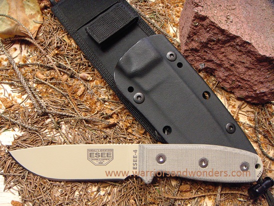

1) Esee 4
- Great size and weight, has a molle back which I prefer. Great warranty
Specs:
O.A Length: 9.0"
Cutting Edge length: 4.06"
O.A. Blade Length: 4.5"
Maximum thickness: 3/16"
Blade Width: 1.25"
Weight: 7.4 ounces (knife only)
1095 Steel - 57 Rc.
Serial Number On Pommel
Ambidextrous Kydex sheath

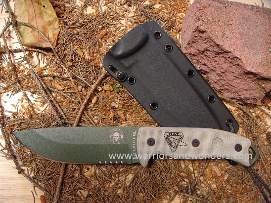

2) Esee 5
- Seems the most robust, great sheath, little heavy but a little longer than the 4 would make wood splittig easier
Specs:
O.A Length: 10.88"
Blade Length: 5.25"
Maximum thickness: .25"
Weight: 16 ounces (Knife Only)
Finish: Textured Black Powder Coat
Handles: Canvas Micarta w/ Bow Drill Divot
Blade Width: 1.56"
1095 Steel - 57 Rc.
Sabre Grind
Glass Breaker Pommel
Standard Equipment: Kyxdex Sheath w/ Belt Clip

had the esee 4 and used it for camping chores and breaking down some wood, which it did fine- didn't make a shelter or anything like that...liked it a lot- especially the feel of the linen micarta handle...

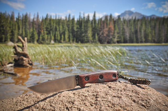

My RC-4 in Cocobolo wood

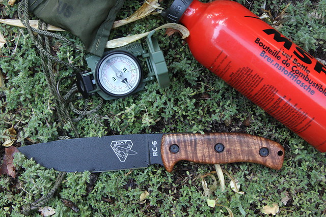

My RC-6 (ESEE-6) in Hawaiian Koa wood
