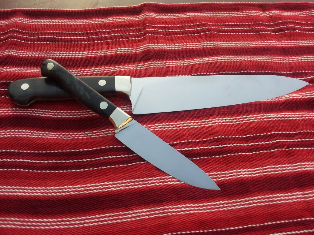

Here are my first two kitchen knives. The Gyuto is 8.25" and the Petty is 4"
Both have Smokey Quilted Maple and Nickel Silver corby/peened & soldered bolsters
Steel is O1 tempered at 400
