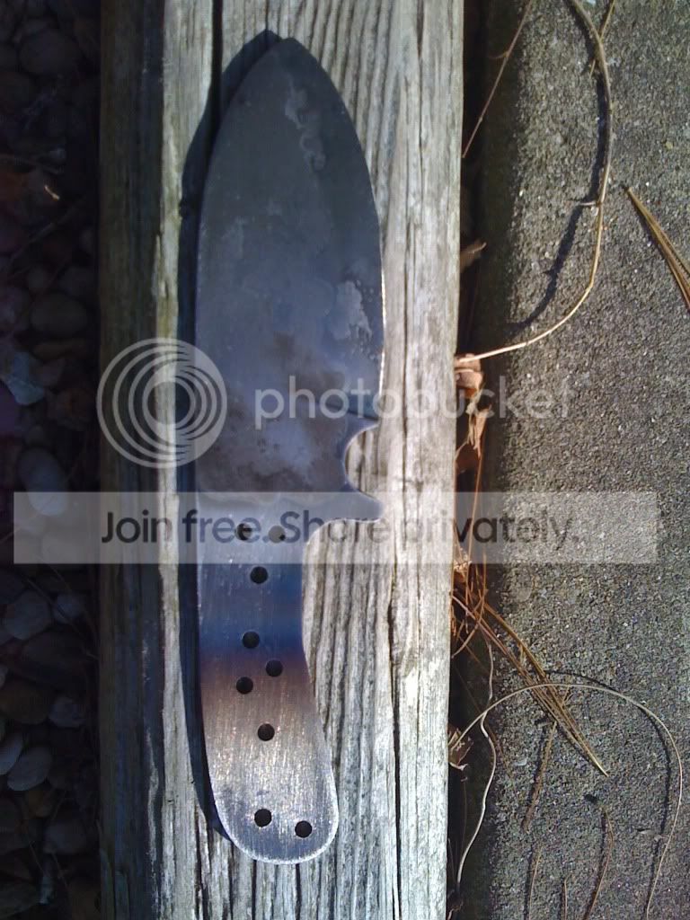

Got my 2nd knife ready for heat treat. It's 1080 1/8 in thick. Got a 4 inch blade and about 9 inches oal. I heat treated my 1st knife using a two brick forge and propane torch. It was O-1 and seemed to harden right up after quench. File skated right off. I thought 1080 would be even easier. Fired up my forge this morning and had the blade in for over 45 min. Had the area dark and it looked to be a dull orange color to me, but never got to a non-magnetic state.:confused: I figured I would try and quench anyway using veg. oil like before. File still bites so obviously not hard enough for the blade.
So experts, now what? I really like the design on this knife and want this to work. Is it still able to be salvaged? Do I just need more heat? Thanks for the help in advance.

If it never got to non magnetic, it just plain didn't get hot enough. Make sure you warm your oil up.
You should be able to quench it again. I would give it two or three stress relieving heats to about 12-1300 degrees. I see it as a very dull red and still magnetic. Just heat and let it cool in still air. This will relieve any stresses and possible grain growth that happened during the first quench.
After that, try again with more heat. Check with your magnet regularly and remember, it has to go past non magnetic a bit to get to proper temp but also be careful to not overheat.
Ditto on the non-magnetic, also check your magnet, I have has some give up, maybe overheated and other work fine all the time.
Thanks for the replies. It's Admiral Steel 1075/1080. I will try more heat with my coal/charcoal forge. Hopefully that will do it. It should easily be able to get over non-magnetic and thanks to everything I've read on here I have been warming my quench oil. This place is full of very helpful people and I'm thankful for it. Here are some pics after first quench and I hit it with some 100 grit to clean it up a bit. I did try for differential heat treat with furnace cement. Hope it turns out.

Big yes on the temper. Thanks for the replies. What do you all think of the design?
The design looks okay to me. It's hard to tell from the pics, but it looks like the furnace cement was applied really close to the tip. If you try it again, I'd leave it back from the tip a bit more. The rest of it looks fine.
I think I got it!:D Fired up the forge today. Did 3 stress relief heats. Got the blade past non magnetic for a bit, then quenched in warm veg. oil. File test skated right off, so it's about to go in the oven at 400 degrees for it's first 2 hour temper session.
