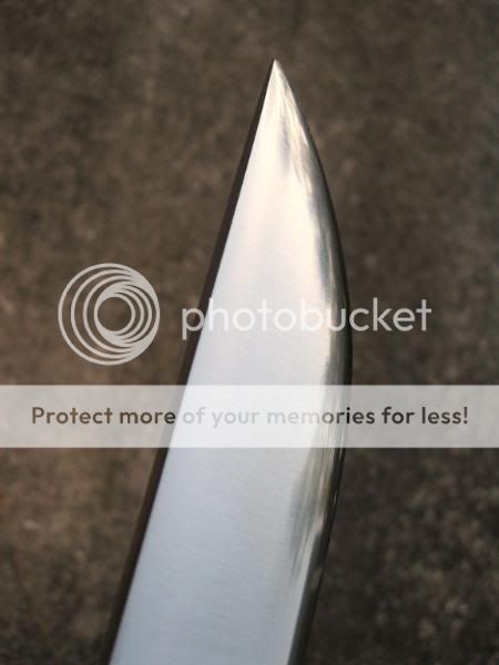

I'm careful to only chop things I should chop, so I spend mucho time sharpening mine to a highly polished edge with diamond plates & waterstones. I'd hate to try to freehand a blade this large with anything less than 8" diamond plates or stones.
If I was away from home (or my waterstones) and had to resharpen it, and only had a 4" - 6 " stone, I would sit down and run the stone along the edge of the blade (Jimmy Fikes demonstrates sharpening using this method in his cutting video). Maybe finish with a few strokes at my typical 15 degrees off perpindicular strokes to get some teeth, or maybe not. To be honest I've never had to do this because I'm careful to only hit wood or vines (no dirt or rocks!), and a Busse will stay sharp all day long chopping wood (as will almost every one of my big choppers:)).
