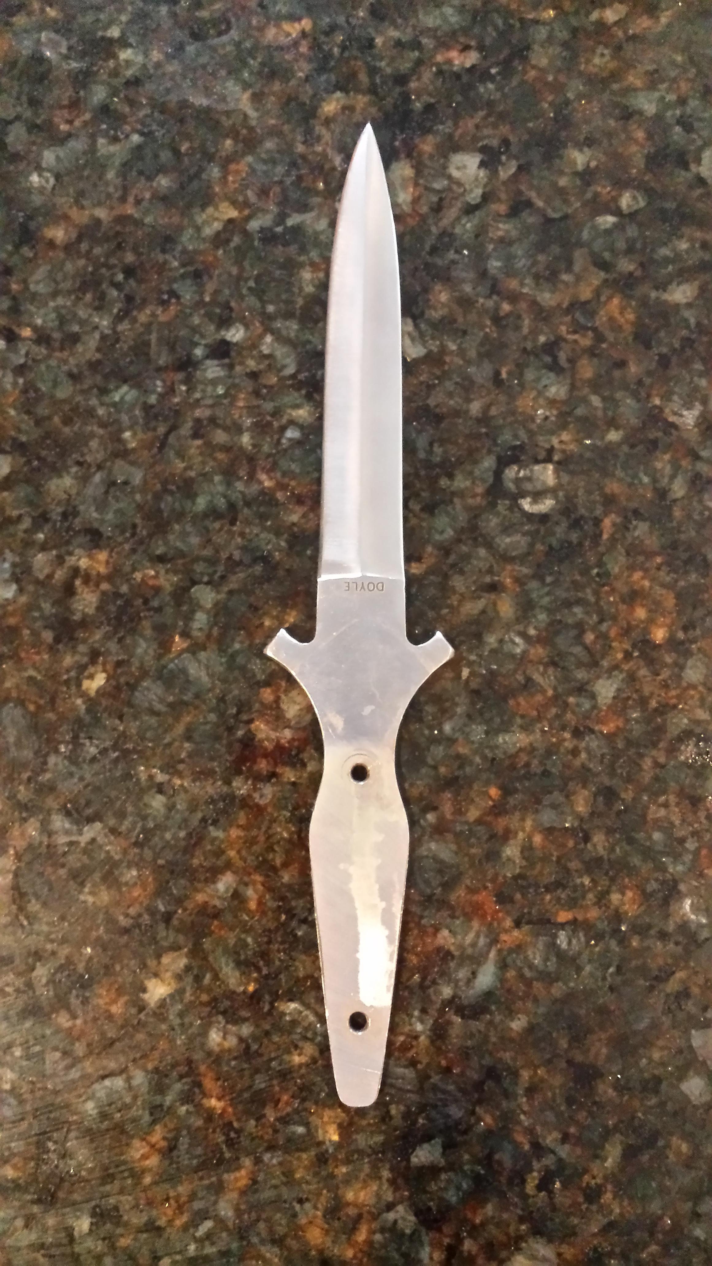

So I have been trying to get started on some basic knife skills, and my grandfather heard about it. He sent me a knife that my great uncle made several years ago. I suspect it is a Scottish boot knife. Anyway, the scales on it (not sure what they were, some plastic things) were cracked and he wanted me to replace them. I'm trying to do this as professional as possible but I'm running into some problems
Here's the knife

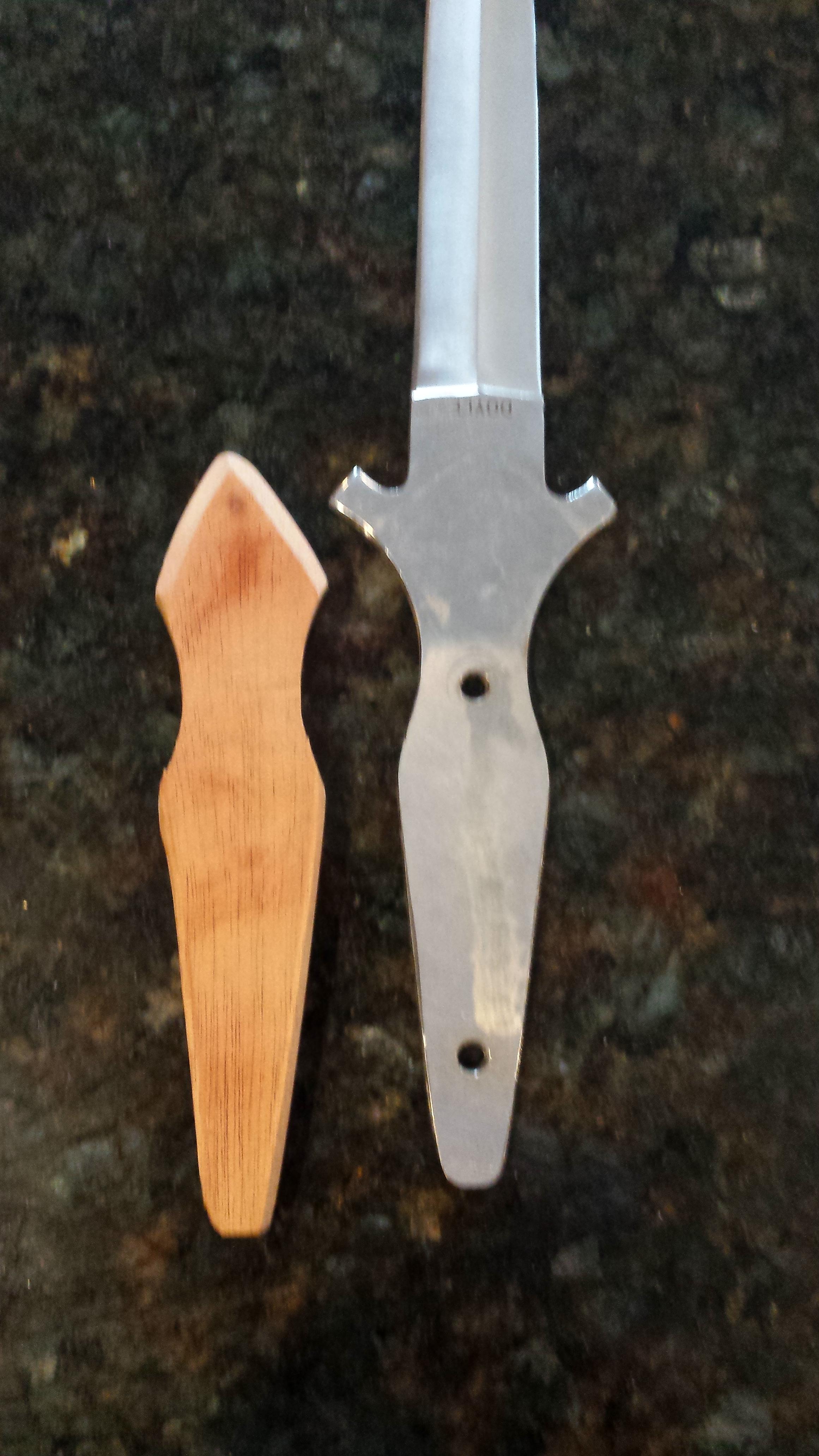

I made a trial scale for it (still super rough)

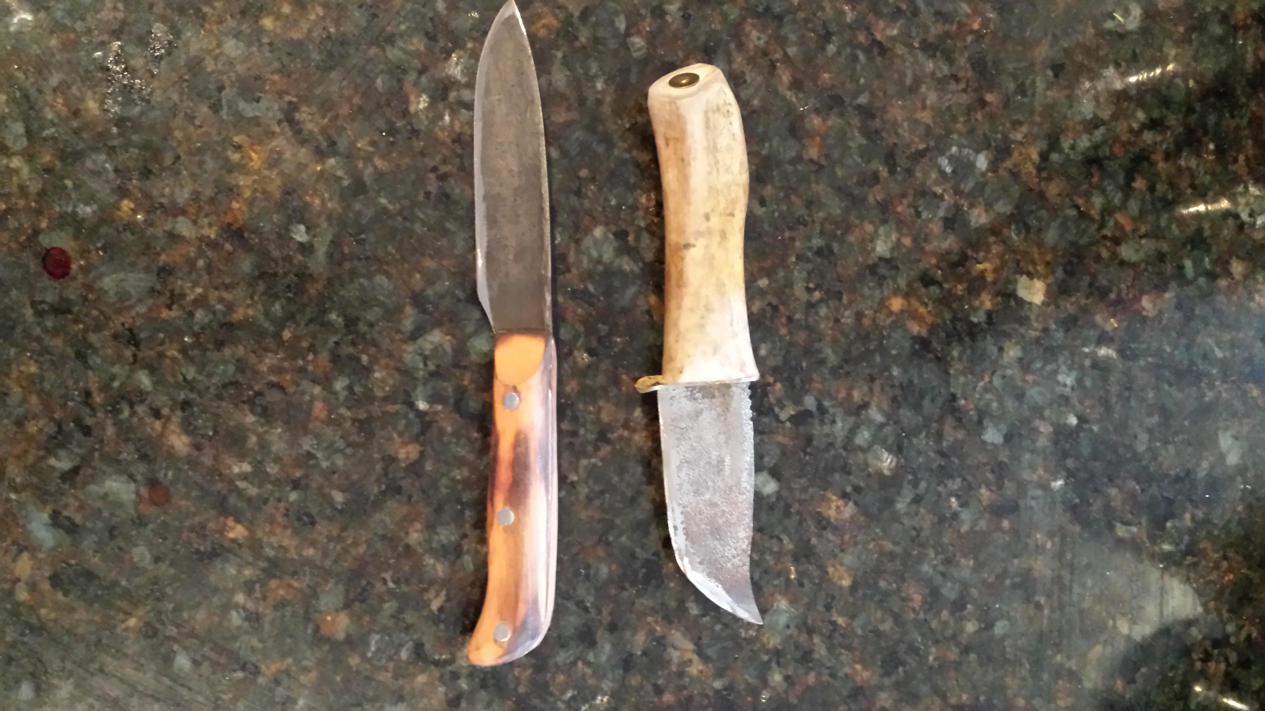

These are the first two knives I ever made, I just finished the wooden one. they were both made out of scrap metal I got from a neighbor.
I'm just showing you so you can see that my skill level is super low and I really do need help with this.
As for my problem, I need to find a way to affix the scales to the knife. I don't want to just use a small metal rod as a pin like with my super rough knife with epoxy. I need something for professional. the knife had like these screw with but with caps. It was interesting but I don't have a picture. So what can I use to affix the handle to the knife?
And what should I do for the handle? The one in the picture it one I carved out of some scrap mahogany and sanded, but I'm not really sure if I should be using something else for this. Should I just use the wood? And what kind of pins should I use? Thanks a lot, and I think I posted the pics right but lmk if I didn't. I used imgur.

I don't like pins, they're to permanent for my tastes. I like being able to take a knife apart whenever I feel like it. So I use screws, threaded posts. and/or threaded standoffs (barrels).
If I were putting handles on that knife I would buy a pair of stainless steel threaded standoffs (they're basically just short pieces of tubing threaded on the inside). I would try to buy ones that are the same diameter as the tang holes in the blade, and choose ones that are just a little shorter than the full thickness of the tang and finished handle scales. If necessary I would file the standoffs shorter to get them to the preferred length.

Part 3. Insert the standoffs through the holes (tang and scales), then install a torx screw into each end of the standoff. I would also counter bore the holes in the scales so that the screw heads would seat below the scale surface. But this isn't a necessary step, and it requires a counter bore drill bit.

It looks like the knife may have originally used "cutlers rivets." These are 2 part rivets that are hammered together. You have to slightly countersink the holes in the handle.
Don't use scrap wood. Go to one of the knifemakers supply sites and buy quality handle materials. The rivets will be available there, too.

Thanks Bill. What does the countersinking accomplish? And I was trying to go ona low budget but i dont think that will work THe scale i made is out of solid mahogany, but i really don't think thats proper scale material haha. And what is your opinion on the other two knives? Any tips? Im new so im just trying to get some feedback for future endeavors

What you describe regarding the original screws are what I refer to as threaded posts. They are basically a tubular nut with a screw head. I use those for various knives, but I think you might have an easier time finding standoffs that fit more precisely.

The other two things are sort of shaped like knives. Knives are not flat pieces of steel with sharply beveled edges, they have much more bevel area. Keep working at it.
