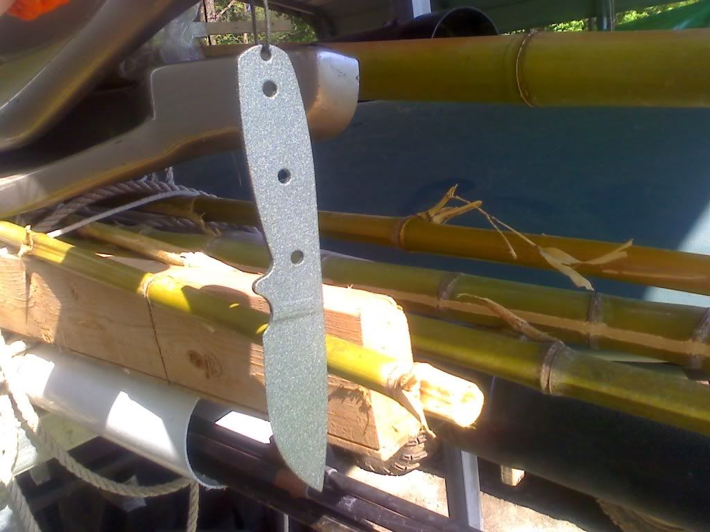

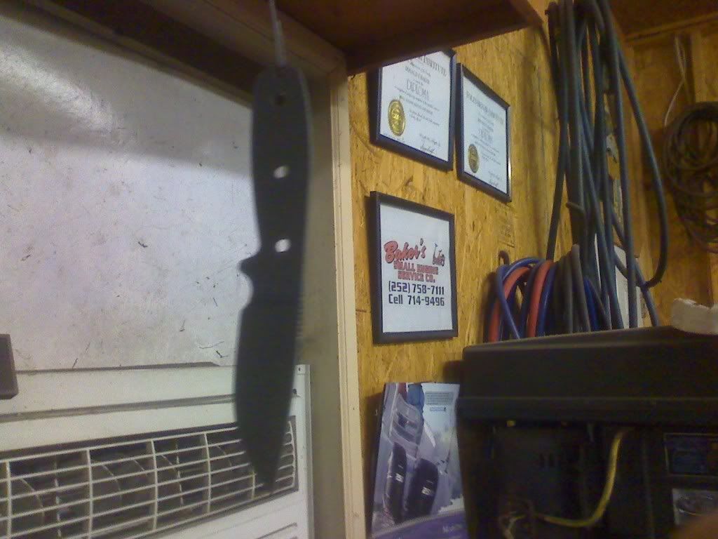

I bit the bullet and did it tonight. I removed the handles and hung from a wire like you said, but I cleaned it with engine degreaser, then since the degreaser was water soluble, I cleaned it off. Then let it dry. Next painted it, being sure to get the choil, pommel, and spine as evenly coated as the rest. Its hanging in the shop right now. It will be 90 degrees tomorrow, so when I get home from school ill take it out and respray it. one question never too sharp, does the coating stand up to being taken out of the kydex sheath well? If not I have a leather sheath for it, and Ill let it ride in that for a few weeks to be sure its hardened.

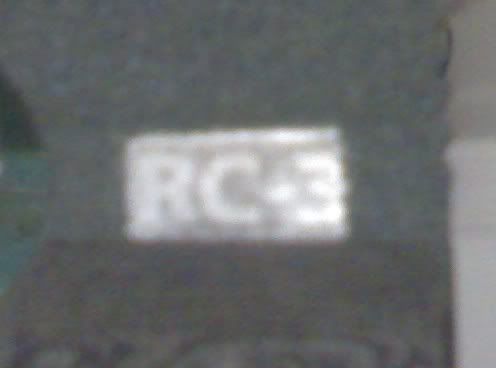

I believe its the same color as yours, its like a little lighter then od but with specks of the white and stuff. I let it dry in the sun all day in the 85degree heat, and then today I put the handle scales back on. It looks awesome with the textured grips. FWI, this was done to the rc-3 from shotgunner11 that he posted a pic of. Ill put it out in the sun tomorrow one more time, then test the hardness. How did you dry yours nevertoosharp? if mine is hard enough, I might try to reveal the edge a bit under the paint. I also did like you with the logo, masking the RC-3, and the ROWEN logos on the blade.

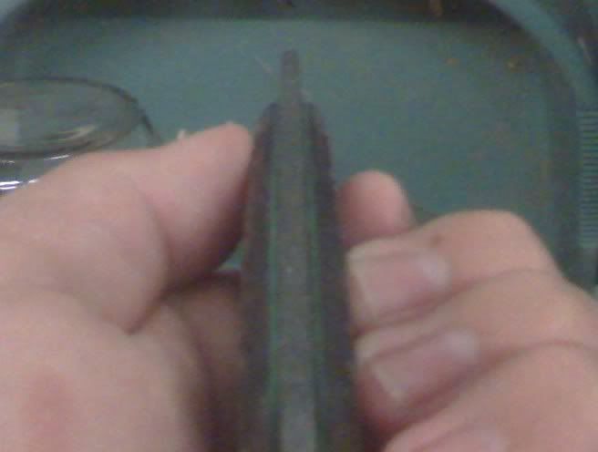

I let it hang for a few days without touching it, then I scraped the paint away from the edge before sharpening. IIRC, the paint color was 'desert bisque.' It looks like sand.

Trust me, I speant about 30min just prepping te blade, first roughened up with 80 grit sandpaper, then degreased, rinsed the degreaser off, dryed it off, then let it air dry, after that got the blade up to 95degrees to promote adhesion. Then I hung it on a wire, via the lanyard hole, light coat, making sure to get the areas around the choil and such. put 2 more coats on today, and let it bake in the 85 degree sun all day. put the handles on today. Imma go take a few pics of it now and post them within the next 15min.

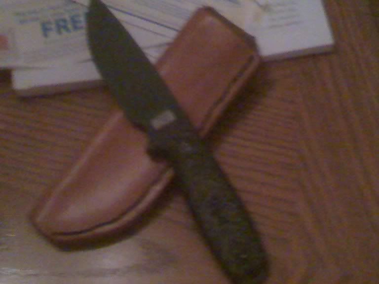

Heres the pics guys, sorry about the one with the leather sheath, taken inside under poor light.
So what do you guys think?
You guys think I should take the handles off again to be sure it will cure under there? I didnt loctite the screws or anything.
did the paint come away cleanly when you scraped it off, or did it try to gum up with all the textured stuff?
It came off fine. I have a little sheep's foot shop knife that allowed me to follow the original edge bevel. The resulting line wasn't totally crisp, but looks fine to the naked eye.
That's a sweet looking knife, by the way. :thumbup:

I'll have to start sharpening it with a course stone since I prolly messed up with edge with the 80 grit sandpaper. I hope it will come off during sharpening. Thanks for the compliments.
