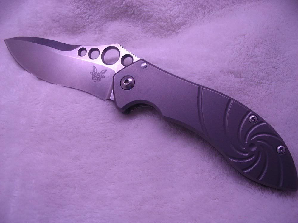

I cleaned her up this morning before work and it was working fine before the cleaning. After=sticky lock. I have cleaned it a lot with no problems? I think I got some lube on the lock bar causing it to slide over to much, and sticking? I should add its sticking so bad at time I have to use both hands to release the lockbar. Then when it breaks free I feel it flexing to much the other way out past the scale.
I might be way off? How do I fix it? I'd rather try to fix it myself, because if I send it off it will not be in my pocket! for who knows how long!
Try some pencil lead on the lockbar face.
It worked! Thanks a bunch, I tried the pencil trick earlier, but I couldn't get to the lockbar face, so I put it on the blade. Didn't work, so I didn't bother with the lockbar face. Anyways I just rebuilt it and put it on the face. BAM that done it! Back to lovin my mini skirmish :thumbup:

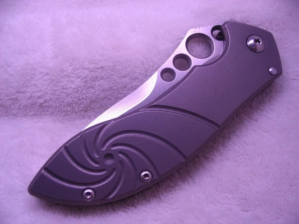

Here she is looking sexy as hell with all her curves
