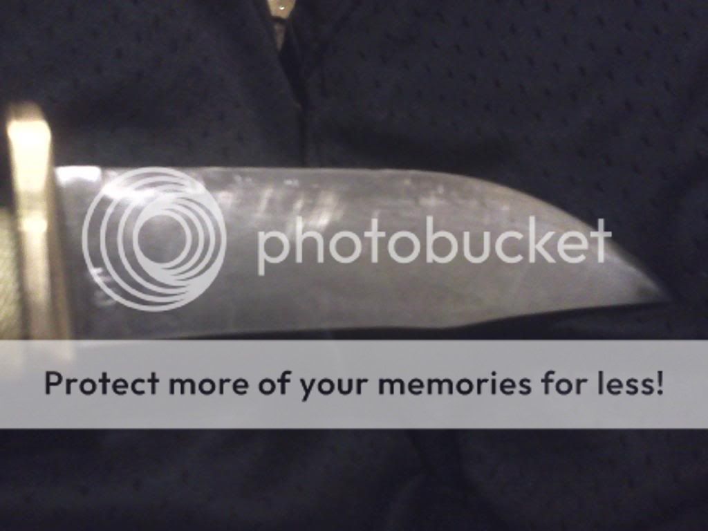

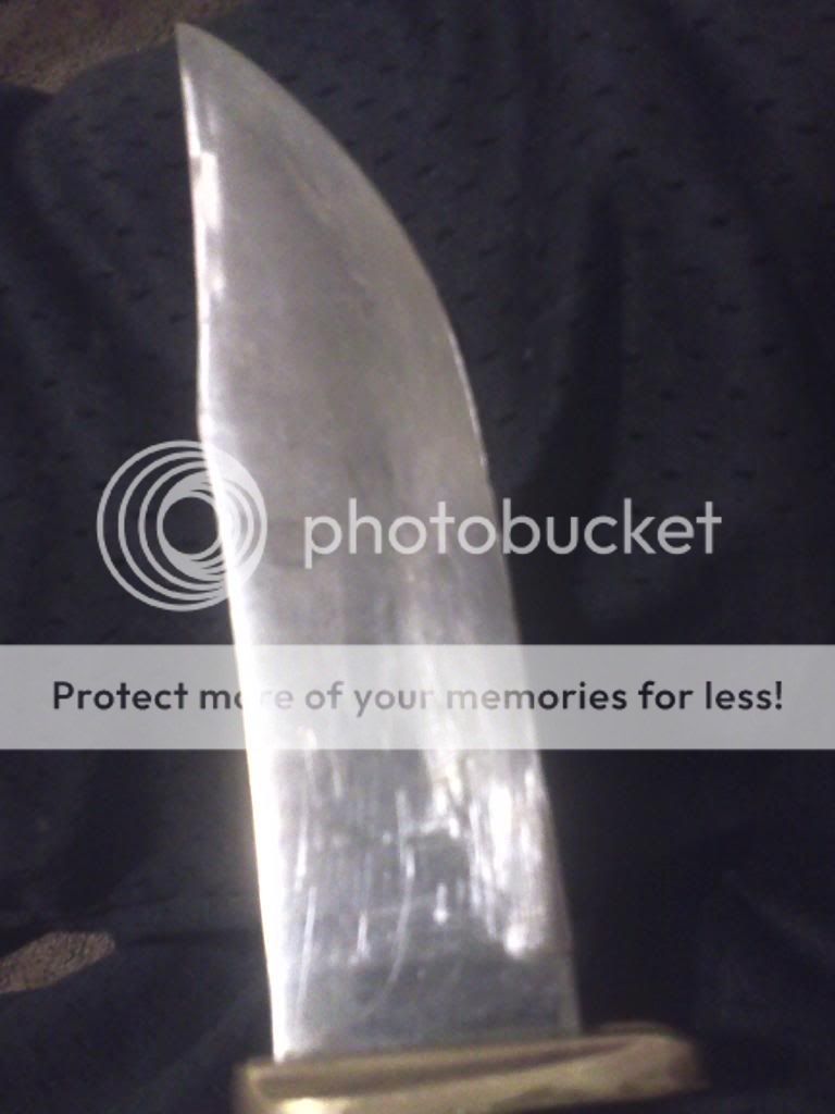

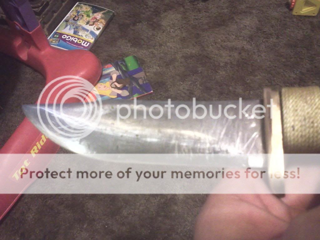

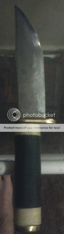

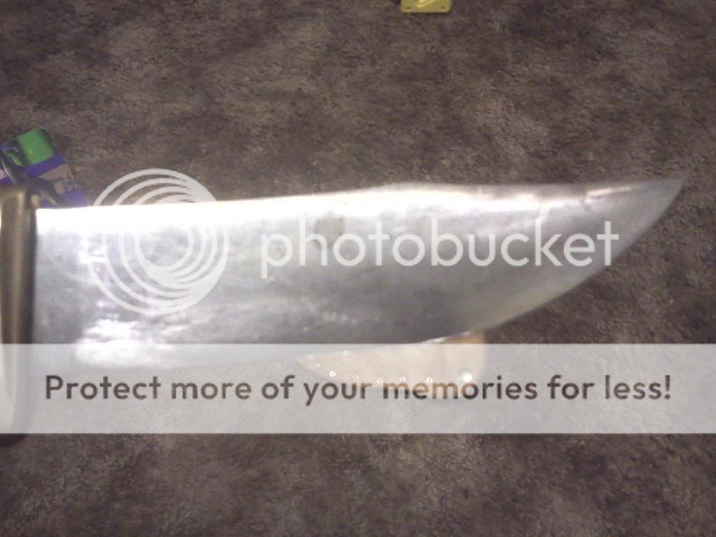

Hello well here is my problem...... A couple years ago my grandpa made me a hunting knife out of a old saw mill blade as my grandpa is over 70 years old he did a amazing job making it but i am finding it extremely hard to sharpen it ( to be expected ) as it is extremely hard metal but my main problem i cannot get the rust spots to go away the whole knife is hand made and was a gift from a loved one so i am trying as hard as i can to keep it in good condition. I've read that safflower oil can help keep rust away.. is that true? And how can i get rid of the scratches and rust spots out and polish the blade? I've already had to even the tang out by the hilt because it was way uneven and the actual edge of the blade didn't start till about a inch and a half from the knuckle guard the metal was so hard i destroyed a brand new bastard file when i fixed it. so if the metal is that hard how in the Hell can i make this knife shine and remove the ugly ass scratches that are on the blade without ruining it? like i said this knife is 1 of a kind and very sentimental to me as my grandpa has passed away since making me the knife...... PLEASE HELP ME I DON'T WANT THIS KNIFE DAMAGED ANY MORE THAN IT ALREADY IS

I am currently downloading photo bucket so i can post pictures of it i did have te app earlier but i guess my phone decided i didn't need it and deleted it but in about 15 min tops it'll finish then ill post pictures of it ..... But as for the humidity I've kept it put up and i have been applying little amounts of 3in1 once or twice a month and its still gettin the dark spots its not full blown rust yet but i would at least like to get the "tarnish" off of it to try to put it close to the condition it was in when it was given to me

Well most of the scratches that was on it came from me unfortunately when i was trying to even up the tang of the blade with a bastard file but good news i took a piece of porcelain to the blade it took all the scratches off after about 5 hrs now im thinking a good buff and it should be done ....... but one more thing i was told not to keep it in a leather case but that's all i have for it as that was what my grandpa made the sheath from soft leather
