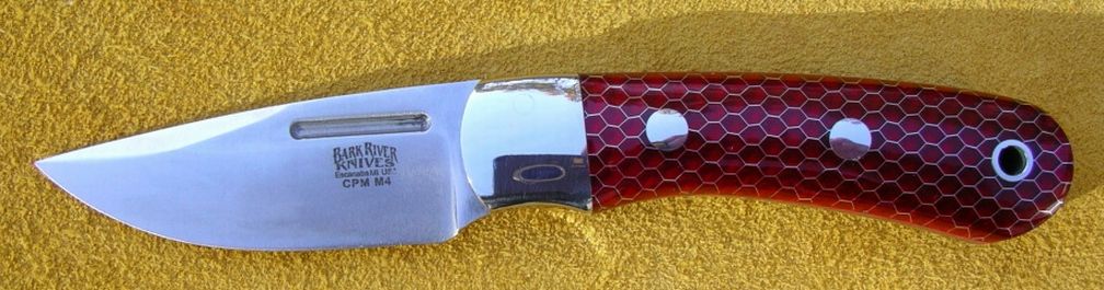

Just arrived:
Bark River markets the "Essential" as the ultimate small EDC knife. With this knife in hand i have to agree.
Most of my smaller FB's are thinly ground slicers but not this one. The blade has a convex grind so there is quite a thickness of steel just above the edge, which is shaving sharp. This M4 has an Rc of about 64. This is a tough knife. If this was about dog breeds, it is the English Bulldog.
I am looking forward to putting this to real world use around my property.

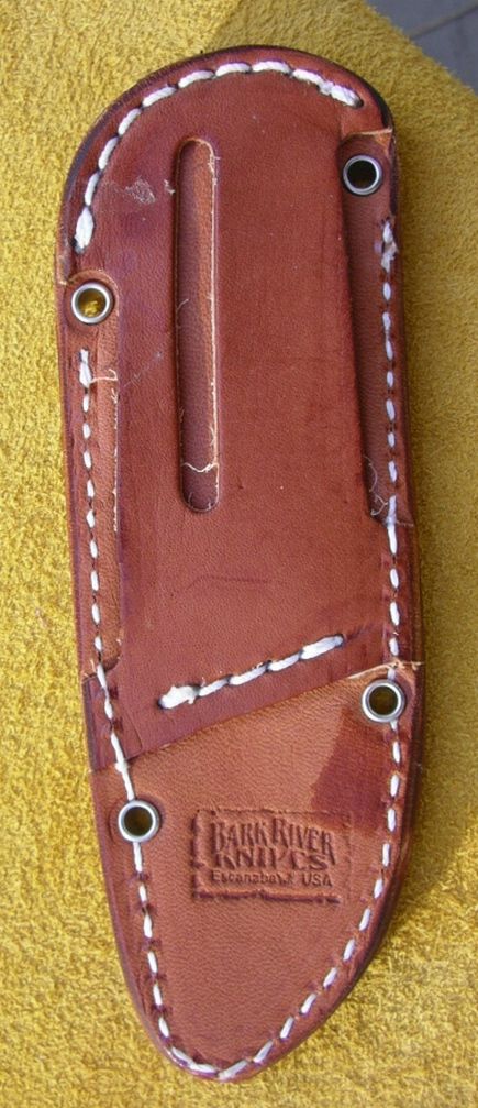

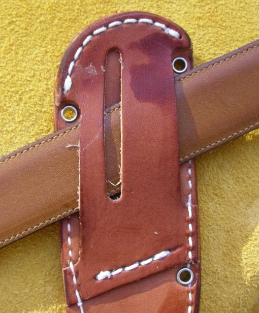

The belt sheath has 3 ways that a belt could be threaded through it. I don't understand why, maybe someone here does ?

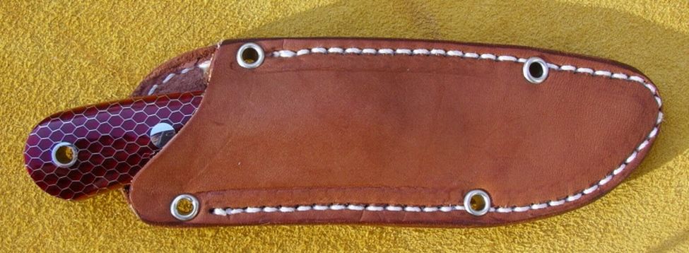

And this is how the Essential sits into the sheath (nice and tight too)
The only 'drawback' is that it is expensive, close to custom level for a respected knife maker.
Thanks for the advice given when i began this thread. The result is i now have this great knife and i am very pleased that i do.
kj
Dat C-Tek :eek: Lovely.
Congrats! Looks to me like it could be vertical carry or diagonal carry. Look how the slots line up. In the first belt pic, the sheath would ride straight up and down.

Jim, thanks, i can see now that the slots are for upright or canted carry. I should of figured that out myself !
