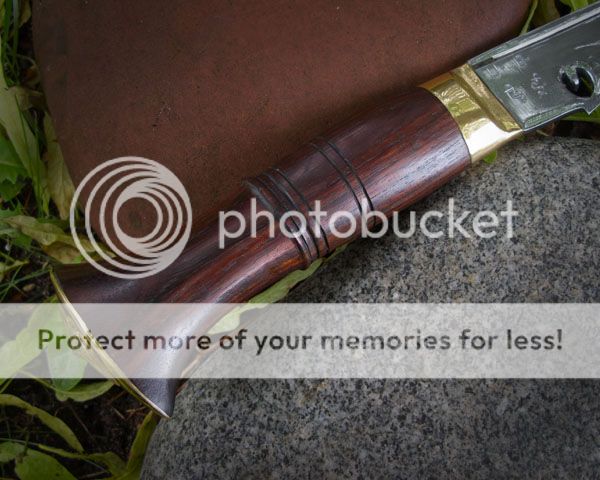

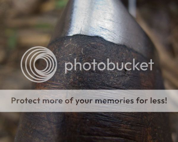

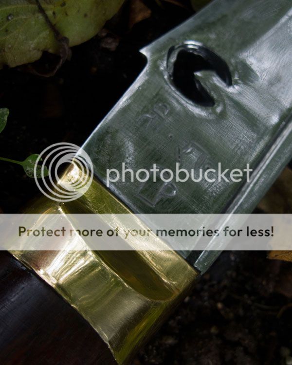

Not too long ago, I started this thread and you guys gave me a lot to think about. I went into quite a bit of detail about the tasks I wanted a khukri for, how I felt my needs were different from most, and was trying to choose between a couple different models. The quick re-cap is that I was not looking for the biggest, heaviest thickest khukri as chopping was not necessarily my main goal. I was looking more for working with green wood, crafting projects, and at best, light duty dead wood tasks, such as fire prep. I was bouncing around between a 20" Sirupati and the 21" Gelbu Special.
Originally, I was leaning towards the Sirupati. I tried to order one, and it was not in stock. I guess it was fate :) Because I started looking closer at the lengths and weights, and started to play with some of my other favorite large tools at home. Even though they were not khukri's, I figured the dimensions and weight would dial me in closer to what I wanted. One of my all time favorite tools is much closer to what the Gelbu Special was. So, I placed an order for that, and it showed up on Friday. Yangdu was awesome in helping me out. Top notch customer service there!
After getting a bit burned on my first ever khukri (from another manufacturer) I was a bit scared in opening the package. As soon as got the first bit off paper off the handle, I started to get excited.
This khukri is nice!!! Looking it over, in detail, there are little things that a picky eye can notice. But, you can tell that a lot of skill went into making this blade.
I should have taken pictures first. But, I was too excited to see how this thing worked. I did some sideways flex testing (as Bill does here) (http://www.himalayan-imports.com/Testing.htm) to make sure everything was good in the handle and handle/blade junction area. I have seen import/tourist type khukri break right away when new, under very light chopping load. So, I just wanted to check things out. I didn't go crazy putting tons of pressure on the thing…..just enough to feel comfortable with the overall design.
The blade was so shiny, the small amount of playing and chopping I did left some scuff marks on the blade. So, these "initial" photos are with those scuff marks. Here are my first pictures of the blade:
To Be Continued…...

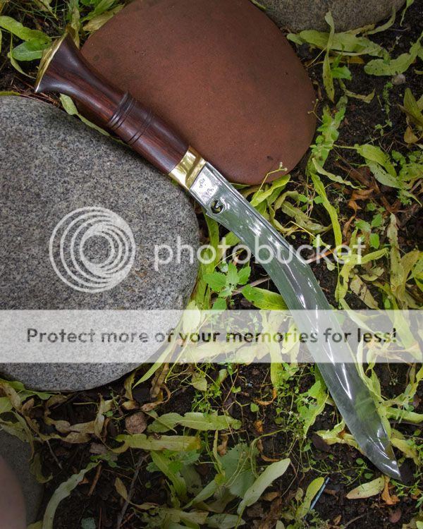

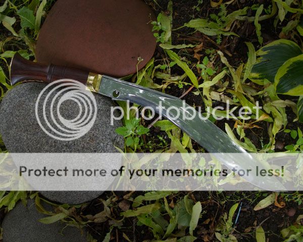

Here is my very, very early initial use impressions of this thing.
First off, I really think I made the right choice with this blade. The length is great. The blade starts out really thick at the spine, but has a nice distal taper. The nice narrow shape, with the concave fuller, yet the long blade give a great combination of length and mass. It is heavy enough to provide a powerful blow, but not too heavy that I still can't do a "machete type" wrist flick with it. Perfect!!!!
I feel this particular tool is right in the sweet spot for me. If I choose to swing with an axe like blow, it still has plenty of mass behind it. If I want a little more penetration and speed, I can wrist flick it still at the last moment. It is a beautiful thing!
Because it has a narrower blade profile, the tip is awesome. Nice and thin, and will come in handy.
A couple things I noticed. The blade is nice and sharp in the sweet spot. I am sure the way it came would make most people happy. I did notice that the tip was not fully ground to the edge. No problem, I will touch that up. Going from the sweet spot closer to the handle, it remains sharp until about halfway through the curve. Again, it ends up not being fully ground to the edge in that area. No big deal, I will work that out later too. Here is a picture, and you can see what I am talking about. The spot that grabs light is a flat spot of metal and it has not been ground all the way to the edge.
After the flex testing, the first thing I did was grab some green wood. I have some ash shoots around my place that grow like weeds! You chop one down and three will grow back :) I don't even want them around on my fence row, but I leave them there for craft projects, making stuff, and cutting tests. I bend a very large one over, and whack right through it, no problem.
Limbing is a piece of a cake, and so is cutting the tip off in machete like fashion. I immediately go back to the big end, and trim the end with glancing blows like I would with a machete (I will make a video on all this one day :) ). Very nice….I am liking it. I take the wood over to the chopping block and can hack fully through any section with ease.

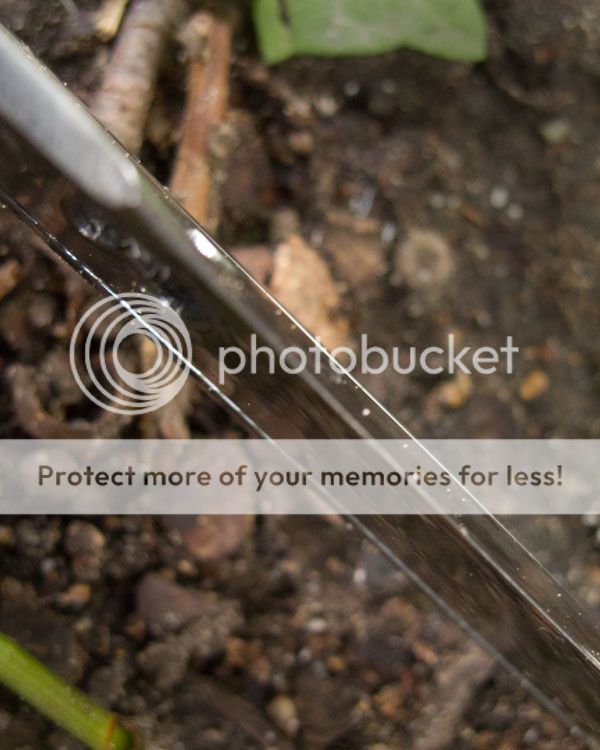

Now that I got my "initial use" out of the way, I wanted to get the full length of the blade sharp. Since I figured I was going to hand sharpen it anyway, I wanted to check the edge hardness to see how hard/soft the edge is in the sweet spot, the tip and the area close the handle. I used rockwell files and checked the hardness the length of the blade. Everything is good as I would expect so I used my pocket waterstones set and worked up a burr on both sides all the way up and down the edge. . I knocked the burr of with leather loaded with a polishing compound. The edge is now nice and polished and ready for some more work.
Once sharp, the tip on this things is amazing. It is ground thin (which is how I want it), and because the blade has a fairly narrow profile, it has an awesome tip on it. The sweet spot of the blade is ground with great geometry. Not to thin, not too thick. The area in the curve, closer to the handle will be used for more detailed work, and has a bit thicker geometry than I would like initially. But, I will get some real world use in before I form too much of an opinion on that area of the blade.
Overall, I am extremely impressed and happy with this blade. I am glad I have it, and I can't wait to get it out for real and have some fun with it.
Here are some final pictures, just in case you are interested. It was hot and humid out, so the shiny blade was kind of "Fogging" up. Not the best pictures. I re-polished the blade later, and everything looked fine, even though I am not the type to worry about looks. In a few weeks, this thing will probably start to develop a patina.
I will do some more in depth reviews as I get more use on this thing. I would like to say I will get a video done, but we see how that goes :)
I am writing an article on big blades, and this one will probably be featured. So, I may end up using my reviews/videos for those articles, which means I can't publish the same stuff elsewhere :(
Take care,
Brian
