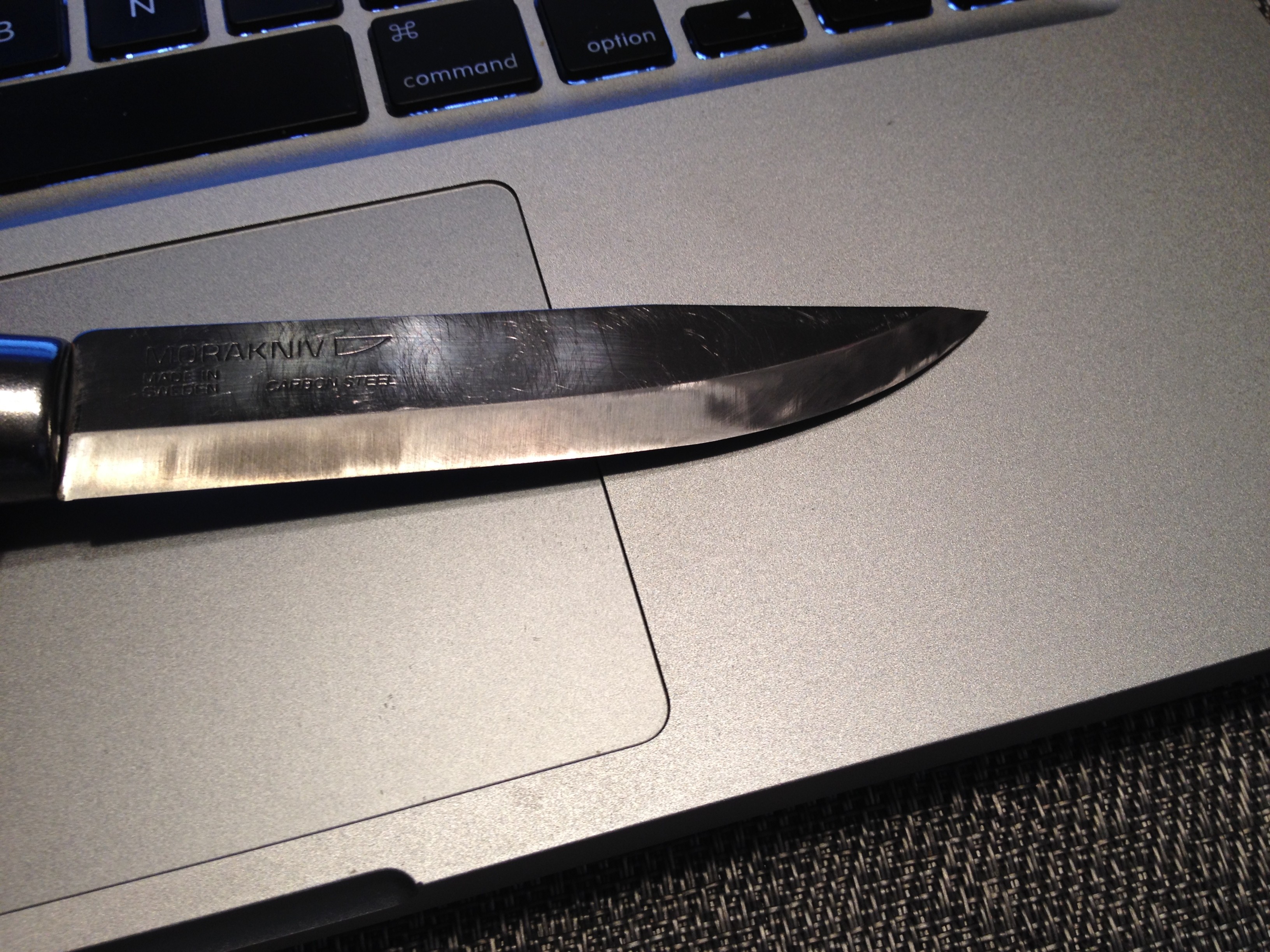

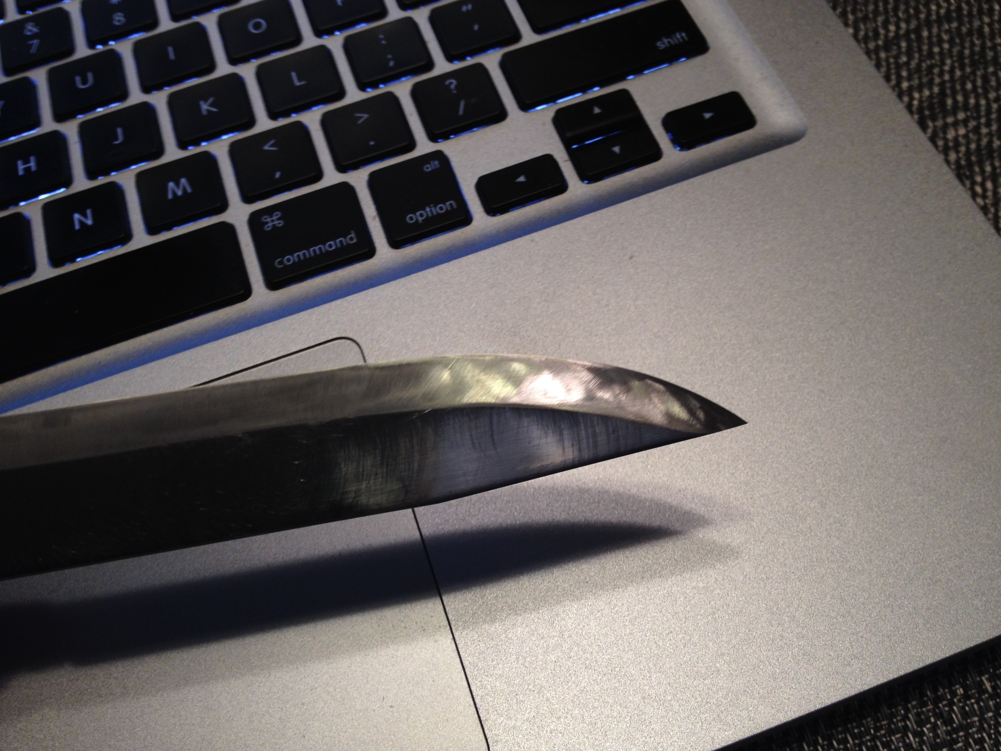

1. How is it possible to put a perfect finish on the bevels of a Scandi grind, which is basically a single bevel on each side. The scratch pattern I get is insane and ugly. The knife gets shaving sharp and at the end of the day that is all that is important, but I would like to continue my development in sharpening. I feel the next step is an even finish along the blade road, how do you guys manage it? Do I need to bust out sand paper and a flat stick or finger stones? Since there is only one bevel on each side, how do I prevent damaging the edge with the sand paper/finger stones after the knife has been sharpened?
Here's a couple of pics, which will show you the uneven scratch patterns I am getting. Keep in mind I'm not talking about the flats, just the blade road on the bevel.

The Mora will be helped if you can work from the shoulder out to the apex when grinding. It also helps to apply a very slight roll as you go. The bevel will almost always have some amount of convex and that is what is causing the hatching you see, so you can make it perfectly flat, or soften it a bit by blending the scratch pattern. Is very common when doing broad scandi and full convex by hand on hard abrasive surfaces, aggravated by any shift in rake path across the stone - edge to grinding direction. The slightest of roll will blend this in. You can also use some sort of strop, even a sheet of paper with mud from your last finishing stone will probably do fine wrapped around one of your other stones. Using an abrasive on your leather strop will visually smooth it out also.
With a great deal of care, one can blend the hatching on convex and scandi right off the stone. My level best will finish off the stone with a finish uniform enough that any remaining hatching can be blended in by simply stropping on plain paper. Is a lot easier to use some abrasive on a sheet of paper. If used wet, go light. If you let it dry out you can use it on a dry stone with a bit more pressure, but still light overall.
It might have rolled because you made it too acute. A slight convex or microbevel tends to toughen up a scandi - I use a slight convex. If the inclusive is much below 24* it will start to loose durability (but will be a better carver if used carefully).
