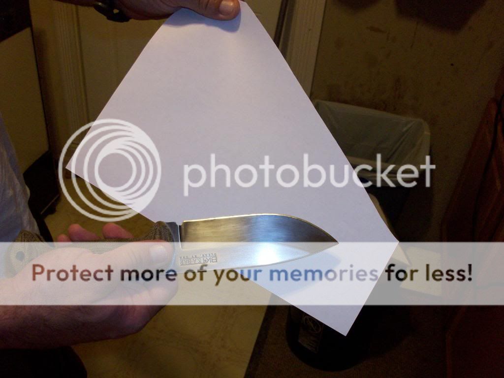

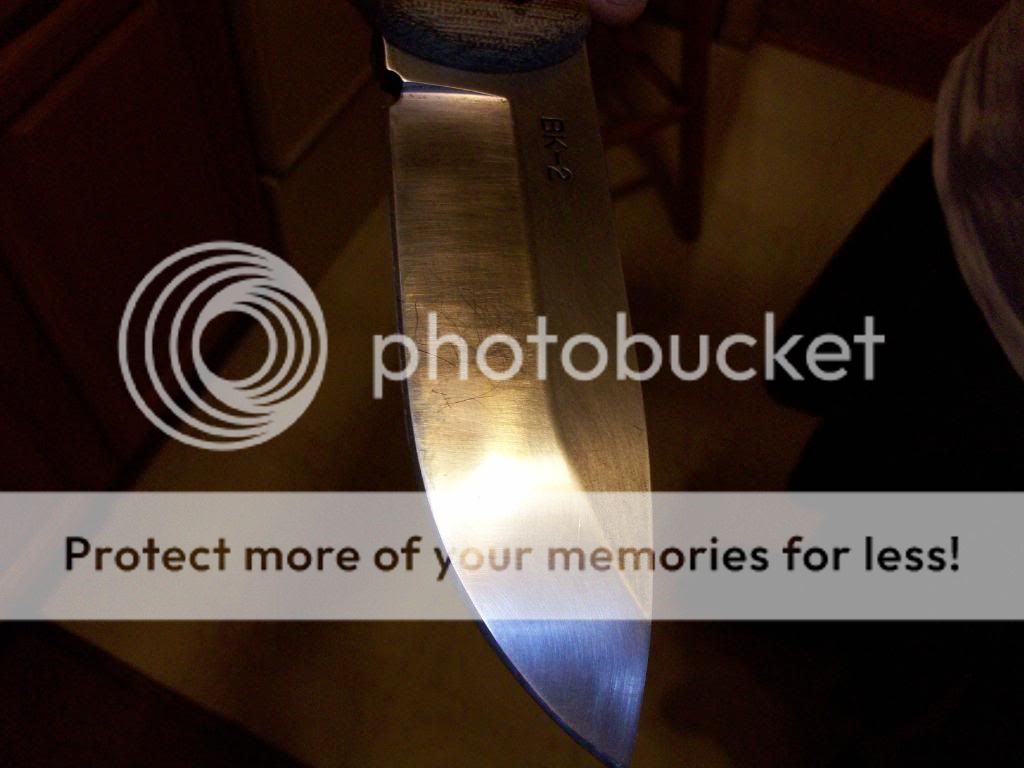

Why didn't I think of this before. So I put the 2 on the 8" rotary grinder. Its a little ugly now but after some belt work and fine tuning, it should turn out very nice. Right now it is very sharp. Maybe tomorrow it will shave.

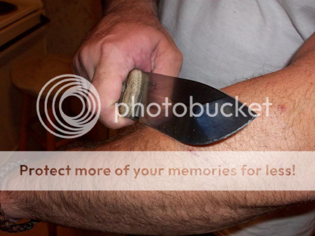

I'm learning to use my WSKTS free hand where you rotate the head and hold the blade static and instead move the work sharp.....for the first time last night I shaved a patch of arm hair with the Bk2.
