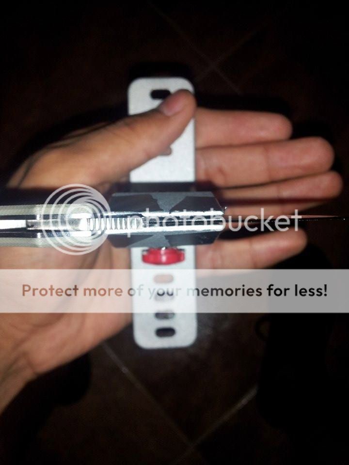

So I bought a Spyderco Dragonfly G10 a while ago, and after some extensive EDC carry, it needs sharpening, I bought a Lansky today, and when I mounted the Dragonfly on the lansky, the clamp does not bite down on the blade evenly, this is due to the blade being FFG and it gets thinner towards the tip, anyone here have any tips on sharpening the Dragonfly on the Lansky?
I decided to clamp the dragonfly like this due to this being the only part of the blade with a flat surface area but I feel like its going to cut an uneven edge on the blade.
I know I can easily test it out myself and see how it works, but I want to take precaution and take advice here to prevent unnecessary removal of extra metal. I have the Stone system not the diamond so it's a bit slower.
Here's a pic of the sharpied edge after about 30 seconds sharpening on the Coarse stone, it seems about right, its only cutting in the middle, but I believe thats due to my failed attempt at free-handing earlier and put a slightly convexed edge on it.
Any help is greatly appreciated

I think you need to meve the clamp down away from the handle as it looks like it is at an angle.
Get the clamp off of the ricasso/tang of the blade, and move it forward of the plunge grind, where the clamp's inside surfaces can get full flush contact on the sides of the blade. The open gaps between the clamp and the blade, seen in your pics, will allow the blade to move too much. Don't worry at all about trying to keep the clamp's sides parallel to each other, and instead focus on getting them fully flush to the sides of the blade. The hold will be much firmer, done that way.

Good point, although doing this throws off the previous angle I had on the blade, so i'm going to have to start back from coarse. Hope it works
Cant think of any reason for you not to clamp it the way you have it clamped. Probably easier/more accurate then trying to clamp on the FFG. The bevel you have there looks nice and even , but your going to be some time getting it knocked down to your selected angle. Not a problem though.
The unsupported corner of the clamp, at the outer edge (nearer the tip) is what would be a problem. These clamped setups will tend to rock, pivot or otherwise move if the clamp doesn't have flush contact at both corners, and more so when more than half of the clamp isn't flush to the blade (as in this case). It gets worse with relatively smooth-finished or polished blades, as they slip inside the clamp more easily. I've seen this with Lansky (2 sets), Gatco and the DMT Aligner.
About the only time I've had to use the tang/ricasso to clamp to, was with sabre- or hollow-grinds (see below) that wouldn't otherwise have enough, if any, flat blade surface for flush contact. I only do it as a last resort, and then make sure to tread lightly while sharpening, else the blade tends to be pushed out of position in the clamp.
David
This might sound a little whack, but the unsupported part of the clamp...I unclamped it and removed the knife, and got some Play-Doh and put some next to the ricasso, on both sides , I then re-clamped it, that way the part of the clamp that isn't touching the blade has something to support it, I let it dry overnight and I am now in the process of sharpening, who knows if it works
