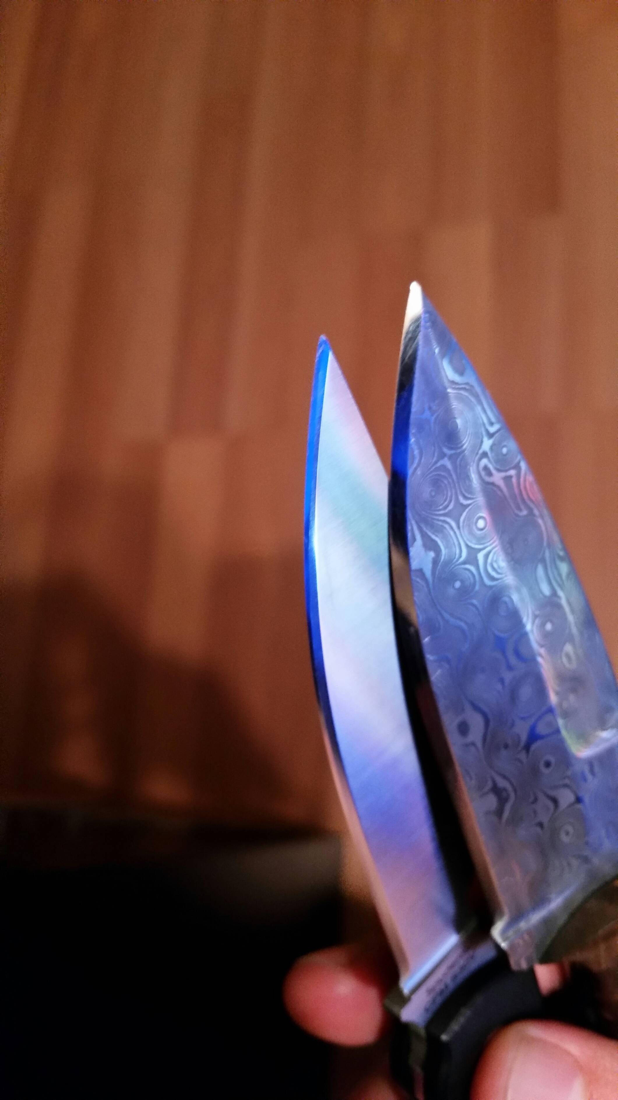

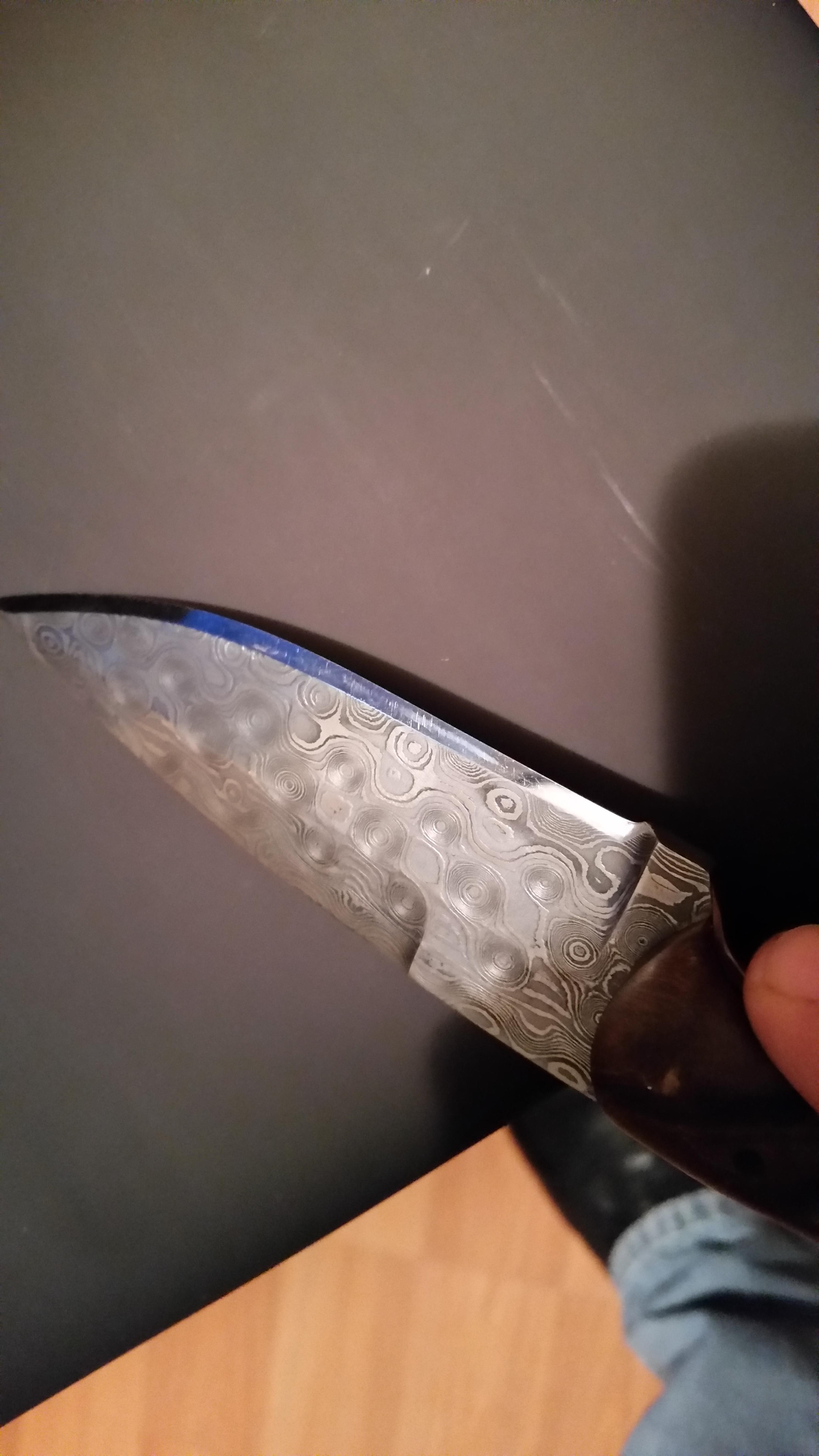

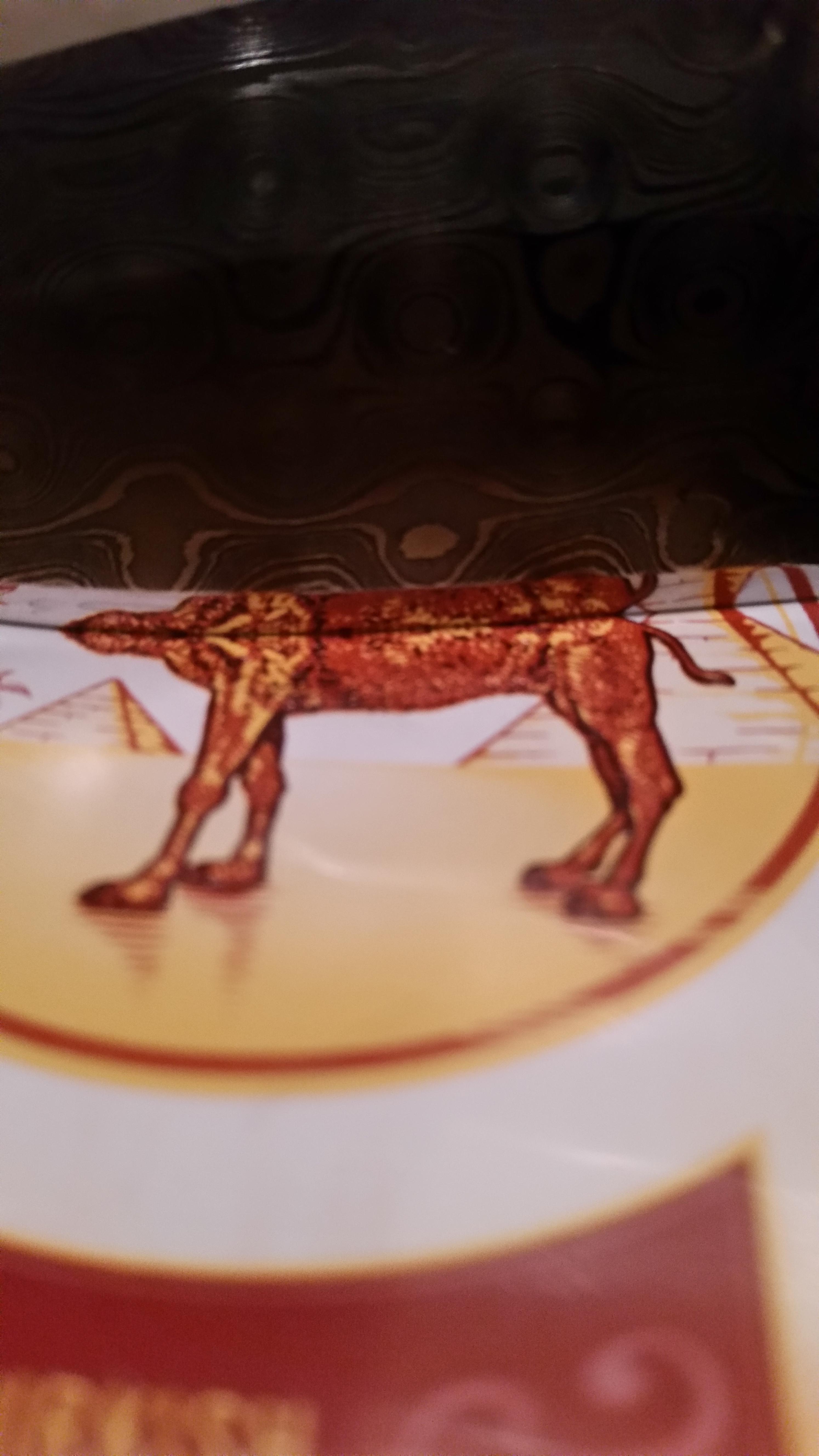

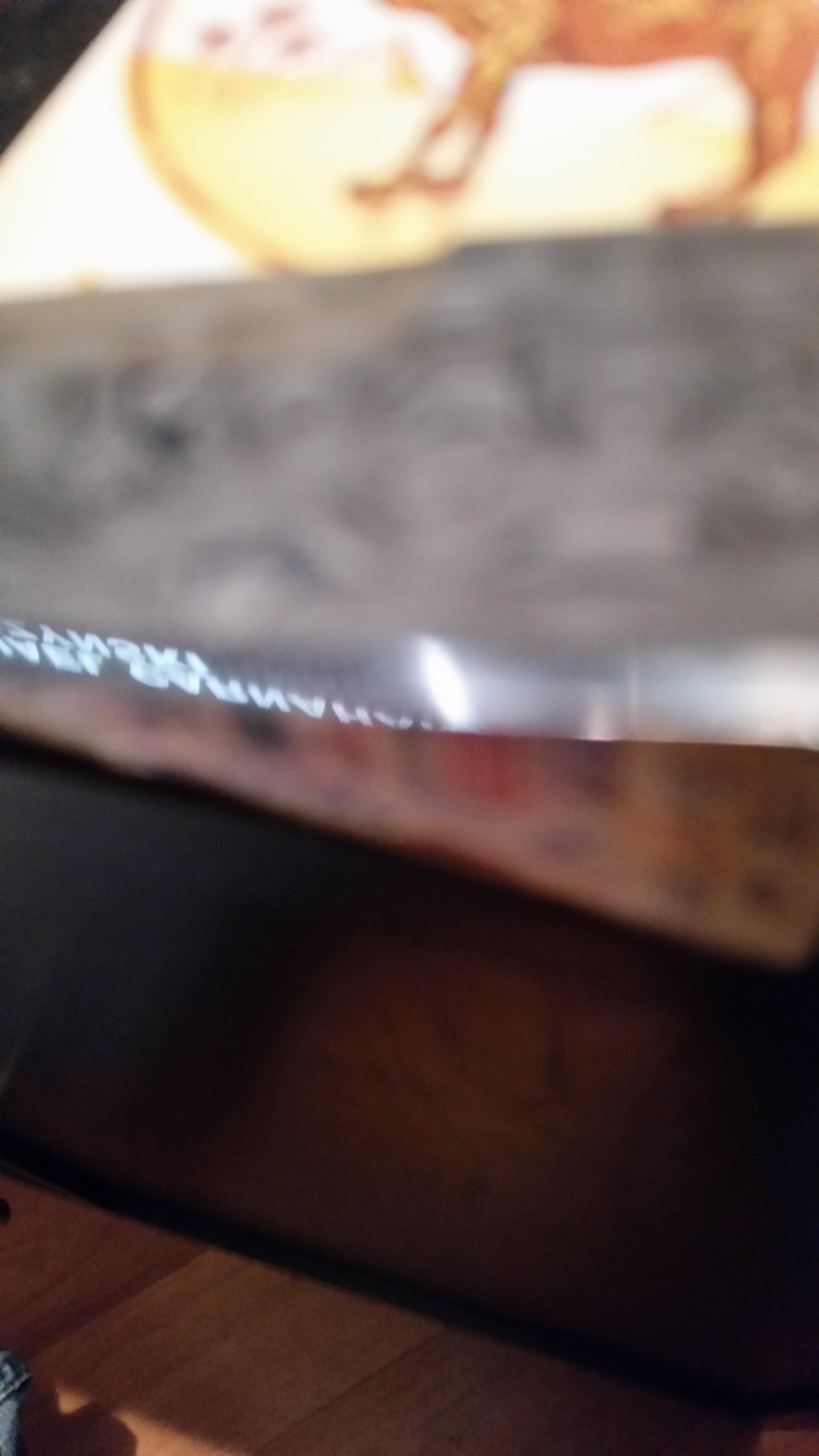

With the aaidee stones or whatever their name is, the ones on amazon, I just brush a light layer of oil on them and go. Once I finish the progression to 2000 grit, I dry the stone as much as possible then polish the edge with the dry stone. Leaves a very good finish. Then I strop up to 14000 grit with Diamond paste and get mirror finishes, but with very light streaks that are visible at a certain angle and not visible at others. If I went higher those streaks would disappear but I'm fine with the edge at that level. I can readily whittle hair, shave my face, cut through cardboard like butter, cut through plastic like it's not even there. So yeah, the stones are at least adequate. I can get knives just as sharp with the Congress stones but it takes longer and the finish is quite noticeably worse. So that there's the reason I leave them for other people's knives, especially if I'm simply doing them a favor on my own time. If they're paying me, I make sure the result is the best I can make it.
Give me a couple of minutes and I'll show you the results of my setup that cost about 60 bucks and some edges that I can get
Those scratches are really hard to get on camera. Took me about three minutes of messing with angles and lighting to get them to show up, but they're there.

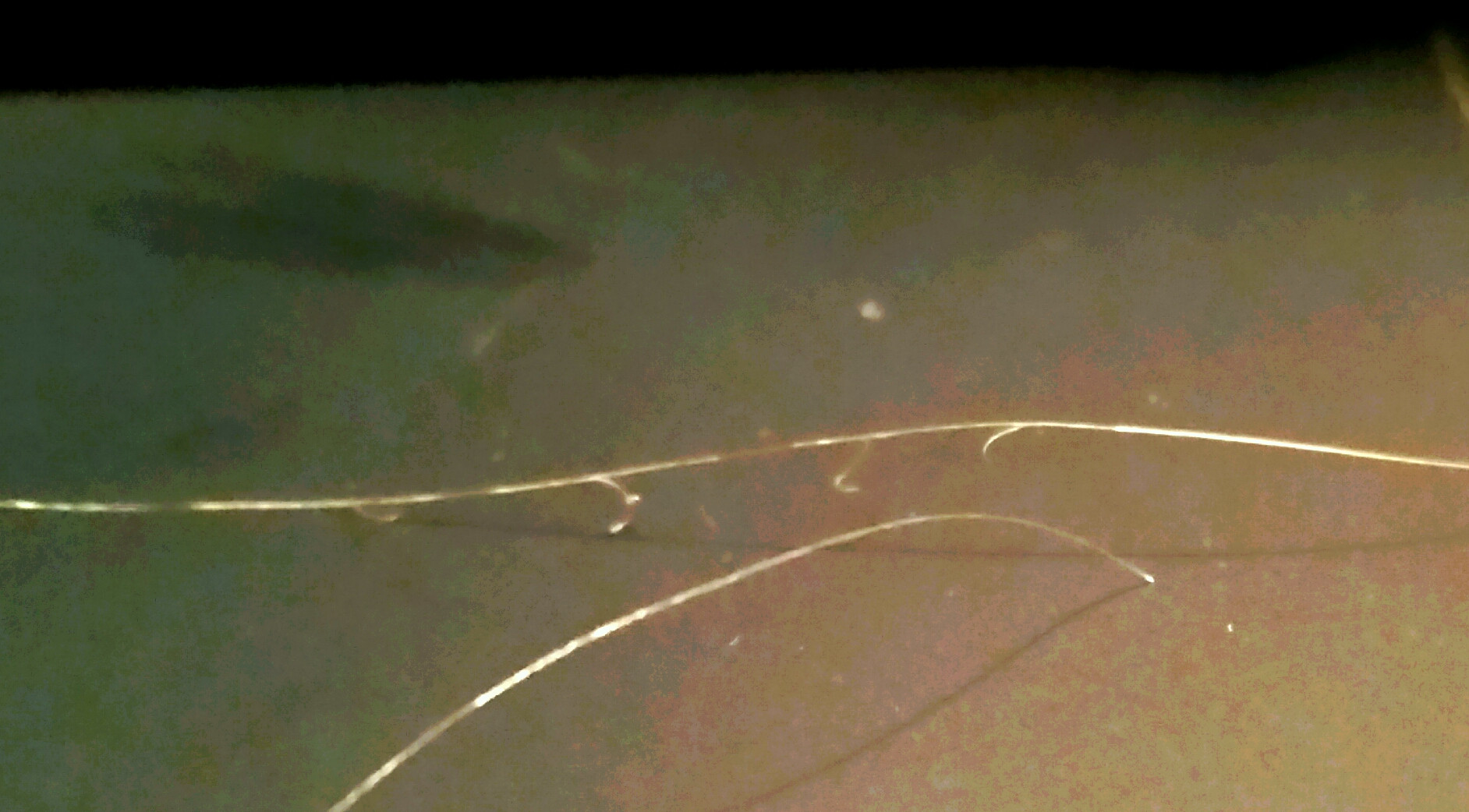

Here's my wife's hair whittled on a little. I messed with the colors and stuff to get the pieces to show up better.

No problem man, the actual grit is almost definitely more uniform in something like chosera stones or whatever, but these are pretty good and I can buy what, like 2 whole sets for the price of one chosera cut down for an edge pro. The scratches are sufficiently shallow at the 2000 grit level to move on to finer strop pastes which are what really bring out the mirror finish.
My progression is 180, 400, 800, 1500, 2000 grit stones. I then move on to 3000, 8000, and 14000 grit diapaste strops freehanded. I could've and should've tried a different progression with the strops. 3000 to 8000 is a big jump and that's probably where those remaining scratches are from.
