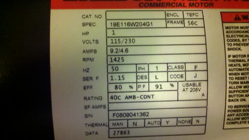

I need some help wiring my new motor. I cant find any documentation on this thing(I've been googling for about an hour).
the Brown van just dropped of my new motor I got a great deal on. Since I'm broke Id rather be safe than sorry and not try to interpret the wiring schematic myself.
I want this thing to run on 110. What wires go to hot,ground and neutral?
My guess would be:
1,8,3= hot
4=ground
2,5,j=neutral
pics in one sec.
Almost , but not right.
First let's fix those pics
You're right in looking at the low voltage diagram.
2,5,J bundled together but not connected to any wire on the plug.
1, 3, 8 together on Line1
4 on line 2
Green Ground to the green screw mounted to the motor frame.
I don' think it really matters which line 1, or 2, you make Hot or neutral.
Polarity doesn't make a difference.
If you find it spinning the wrong direciton when hooked up
1-3-8-hot
4-neutral
2-5-J
Then wire it up 1-3-5-hot
4-neutral
2-8-J
You should be all set.
Thanks for the replys. I got it hooked up and running. This motor is way bigger than I thought it was going to be.
