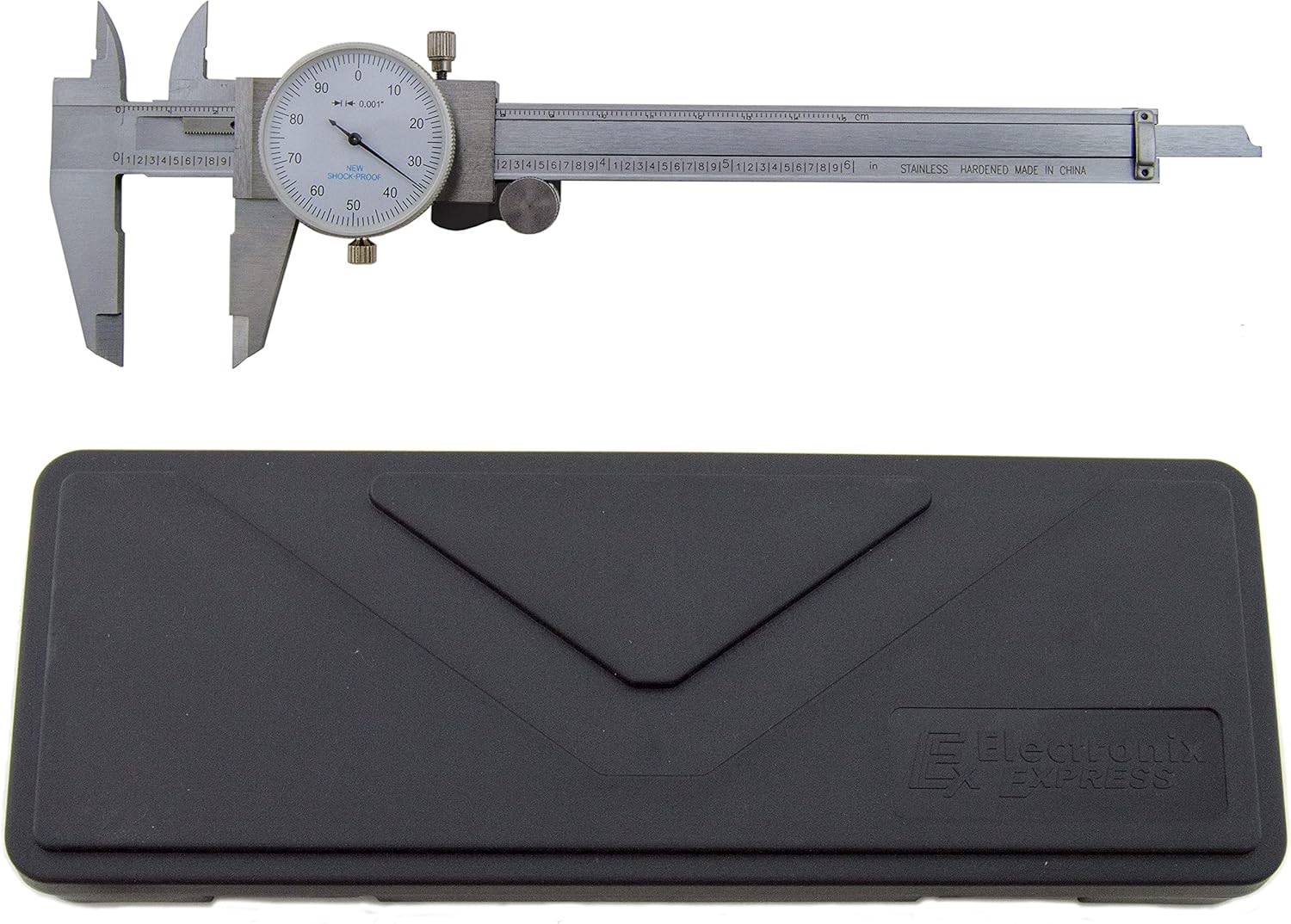

You need an accurate way of measuring. Calipers. Tape measure isn't accurate enough.
Metric equivalent isn't enough. If you need a metric bore, you need a metric bore.
If you need Imperial, then you need that.

Get a six in ch dial caliper

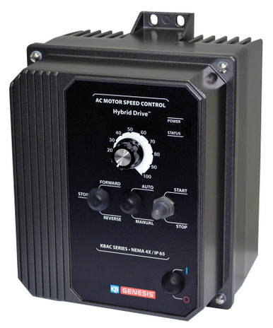

The ideal VFD is of course that KBAC even if it is $400 - or close to it anyway. Many of us prefer to use the Chinese VFDs, perhaps like this one listed on ebay - do a search for "126272221162", it's around $73 shipped. I've been using these for almost 15 yrs now and usually get 5 to 8 yrs life when used on grinders, lathes, etc. I do put a filter over the air inlets to reduce the amount of steel dust inside which will kill the VFD.
They are easy to setup and do give good service. The 2.2KW (3hp) gives a nice cushion to not overload the VFD.
Looking back I'm not sure anybody mentioned exactly why your VFD won't work for you. It says on the front panel it requires 3 ph, 380 to 480VAC input voltage. The output is just fine since the output is the same as your VFD with 380 to 480 3ph output. "IF" you happen to have 3 ph at 480vac, then your VFD won't work.
