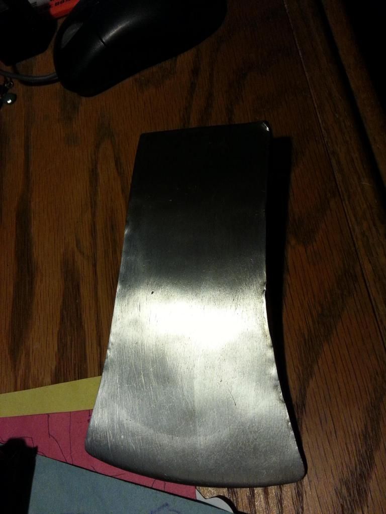

I just picked this up, and have been looking for a boy's axe head to hang on a new handle that I got from House handle. This head is in really great shape but there is no ID. The only markings are on the top and underside of the poll. One side is marked "2 1/2", the other is marked "DY". That's all.
I don't really care what the brand is in particular for this tool, I just want to know that it is a quality head before I waste a good handle on it. Thanks in advance to anyone who may be able to shed some light.
That one has me a little concerned. It seems to have a tapered poll that I see on the imports. Most boys axes are 2 1/4, that one is 2 1/2 and the DY might just stand for Dayton, the axe's pattern.
I don't have experince with them imports. It might be just fine if it is one of those. See what your file says I guess.
Let's have a look at the cheek profile. The imports have flat cheeks. That one appears to have convex cheeks. Might be American made.

Good info as usual. I'd like to learn more and may try a little more research. Failing that, I'm happy enough with your educated guesses to consider that there is a good chance that this is a good head, especially considering the condition. Cheek pics soon.

Possible stamp under the paint.
Temper line visible after sanding up to 220 grit. Stopping here...like I said, it's a tool.
Eff it. I'm going to hang the sucker. To far in now!

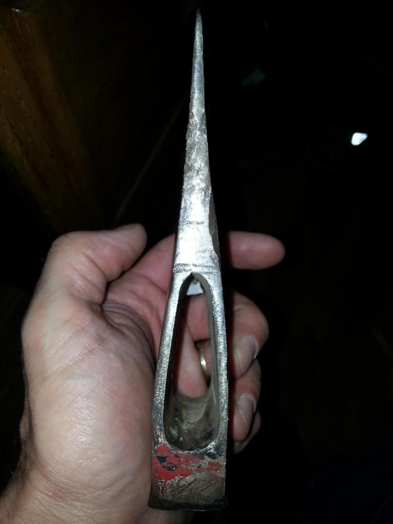

JB, since your last picture I have kept my eyes open for one of these mystery axes. That last picture you posted has to be a forge weld.
So when I seen this one with what I thought was a forge welded bit I went ahead and got it.
I still don't know who the maker is and it has a strange shaped eye(like yours). The forge weld is visible from the toe to half way to the heel.

Thought I would up date some information. The bit is on the soft side for my taste. I have came across this soft of a bit before. They have been on Collins and R King stamped axes. Just my experience and I suspect a less than perfect heat treat is to blame but it may just be perfect for some users, like those that use their axes in cold climates.
My feeling based on everything that I have learned here to date tells me that this is not a forge welded bit. From the style, apparent age, the lack of the slightest physical cue that would indicate a line between two pieces of metal etc., I think that this is a case of the person doing the quenching simply rotating the head instead of dipping it straight. All forge welded heads that I have ever seen have been well made but still had a line where you could at least catch a fingernail. This is one solid piece of steel as far as I can tell. Also, no axe that I have ever seen that would have a forge welded bit would ever have one that could be called too soft.
Quality US and european axes have not been painted red in ages. The impacts on the axe seem to have deformed the steel considerably indicating softness. It even shows small wear scars just from general cutting as it was used. Most probably an modern import.

Or a soft wrought body with a forge welded bit.
