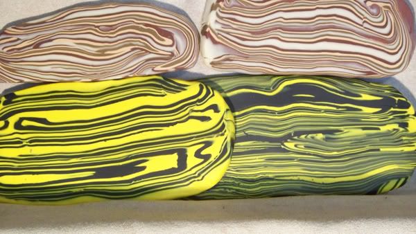

One of the newer materials that I have been playing with is polymer clay. You can decide the colors, create mosaics, do something that looks like damascus with lots of folded layers, do inserts...it is fun material and once baked it is very stable. It is also very inexpensive so you can try several things till you find what you like. It is very easy to shape and you can do the majority of shaping before baking it...just remember it does shrink a bit. Here's a couple I made, thinking about using the top set for a Mule.
