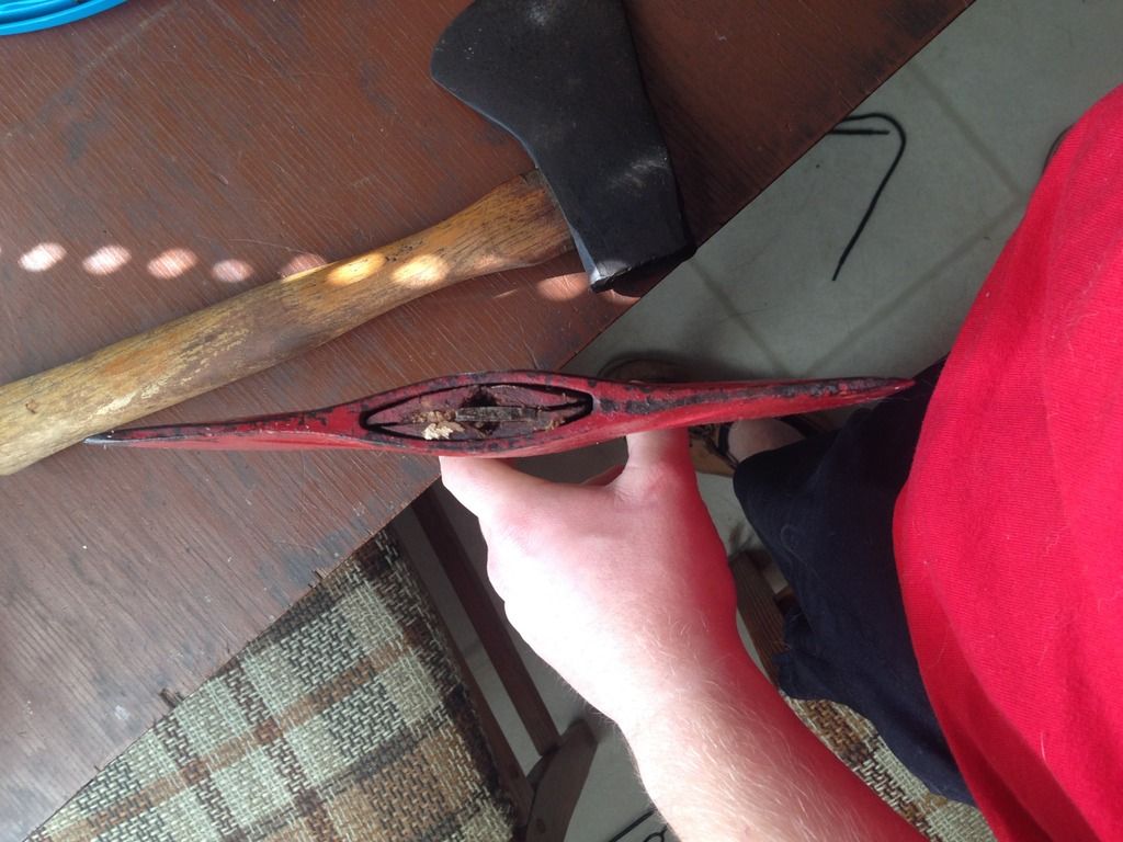

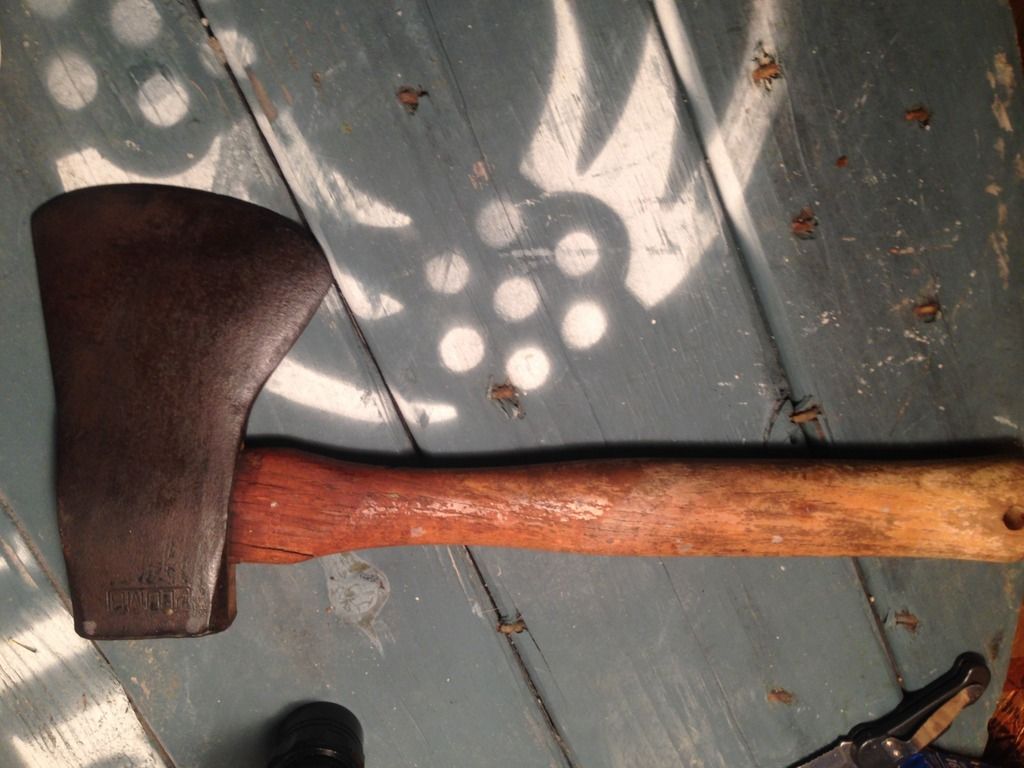

Here are the pictures from the eye end of the axe, i hope this helps. Based on the shape of the axes what are their primary purposes? The hand held axe just seems different to me, in my ignorant opinion when i see the short plumb i would think it belongs on a longer handle.

Certainly both look to be pre 1955 because the epoxy-filled eye versions (post 55) were a sonovagun to rehaft. Wine-coloured handles are proprietary to Plumb. Both of these definitely need to be properly re-wedged! Double bit axes were popular out west and the other is a cedar pattern hatchet without a hardened poll (such as some of them (Boy Scout versions?) do.
They've both been re-hafted so there's no telling the dates. You have a cedar pattern hatchet that would have likely come with a curved haft originally. The other is a pretty standard Plumb double bit. Both are very good axes in nice shape and well worth re-hafting and sharpening.
