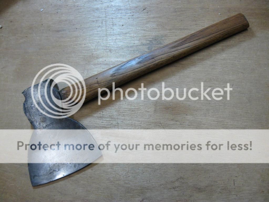

I think that I know enough now to know that this American made axe head is a quality piece based on it's probable manufacturing date range, could I have confirmation?
This head has some surface rust but is in otherwise superb shape with sharp edges and no deformation. I have seen this Vaughan Bushnell logo on older roofer hatchets and am guessing it to be pre-1950's to maybe the 20's or 30's. It looks like a very good user. I'm not looking even for confirmation of quality so much as a little history lesson to add to my knowledge.

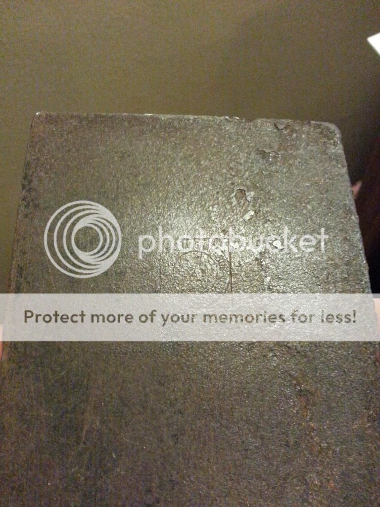

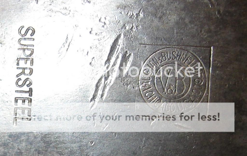

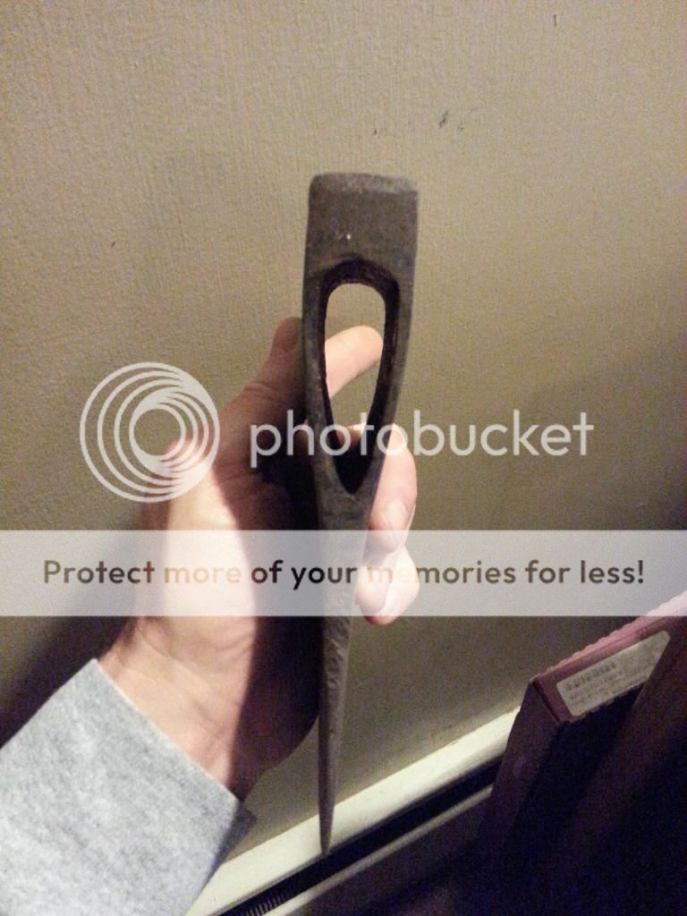

I'm also been trying to date this V&B that I have.
The link garry3 posted might have some clues.
"Sanford S. Vaughan, Alexander's only son, joined the company in 1886 . . . As time passed, obsolete items were dropped from the line. More hammers, and a variety of hatchets and axes, were added."
"The company that is today Vaughan & Bushnell Mfg. Co. . . ."
Vaughan bought out Bushnell in 1922. The newer tools seem to all use the VAUGHAN brand. I don't know when V & B got dropped.
"Limited manufacturing commenced in Bushnell in the fall of 1940, and was gradually expanded during World War II. The town's location and ample labor supply proved so favorable that, in 1950, it was decided to consolidate all manufacturing operations in Bushnell."
Mine (and I assume yours) is marked Chicago. I guess it could have been made from the late 1800's up until 1950.
Mine is also marked "SUPERSTEEL". This stamp was used on "HAMMERS, HATCHETS, AND AXES" starting Jan 1, 1923. http://trademarks.justia.com/731/09/supersteel-73109154.html
As far as quality goes I am not qualified to say. But it is hard to file. And if you like your steel to ring, this one rings like a bell!
rj, good information there. Maybe I just asummed that it was changed to just Vaughn after Bushnell was bought out. I don't recall seeing them supersteel axes with the VB stamp. I need to pay better attention.
