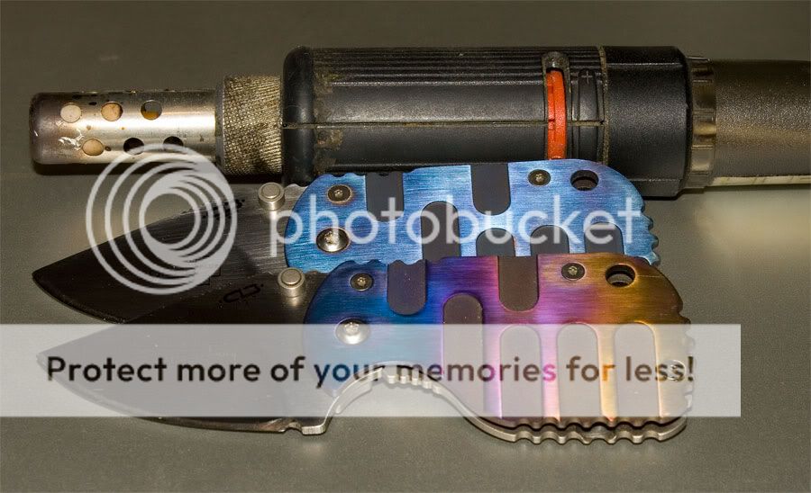

Hi,
here is how it works.
- first try to get the parts as clean as u can (alcohol, break cleaner, etc)
- mount the parts on a wire or something similar
- start heating up the parts
- always keep moving the flame a bit, so that oxygen can get to the part's surface
- let the parts cool down
And here's the tricky part:
To achieve the coloration of those Hinderer beads you need to quickly heat up a single spot on the part to a certain temperature
and then let it cool down.
The smaller the part is that you want to apply this coloration to,
the hotter the flame has to be and the quicker you have to be.
(The part has to be unevenly heated to form an oxide layer with unevenly thickness / color.)
The coloring process starts when you remove the Flame, and oxygen gets to the heated surface.
So you will simply have to guess for the right moment. :D
Here's a short color/themperature chart:
pale yellow: 700 °F
orange gold: 725 °F
dark bronze: 748 °F
purple: 774 °F
blue-purple: 799 °F
sky blue: 824 °F
cobalt blue: 849 °F
pale blue: 874 °F
bluish green: 900 °F
Here is an example:
Sweet! This is the info I was looking for. Thanks for taking the time to write that up. Much appreciated.
