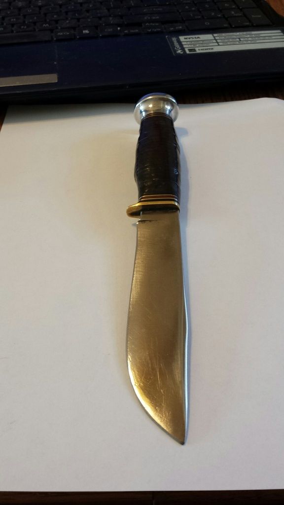

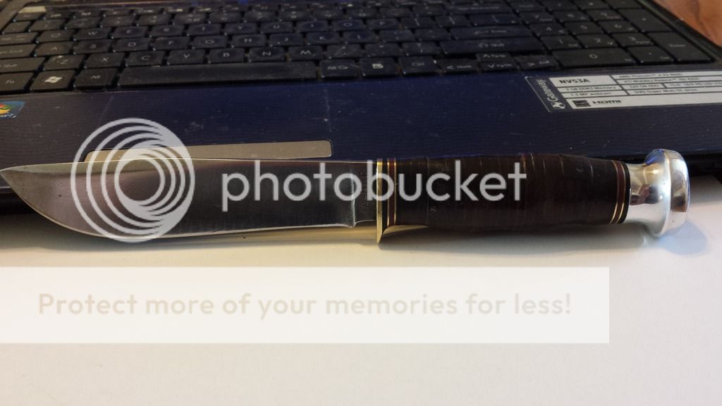

Can anyone tell me what the model is-the sheath has a boy scout insigna on it don't know if it is the correct sheath or not,any help?Sorry for the bad pics,thanks
mm

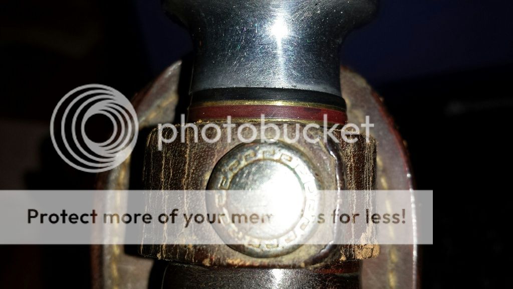

We're gonna need three things -
1- length of the blade (tip to guard) (to the nearest 1/16th")
2- overall length of the knife (to the nearest 1/16th")
and
3 - is the the snap embossed or plain?.
We start with 9 possible knives.
Based on the handle, we can eliminate 1 of the 9.

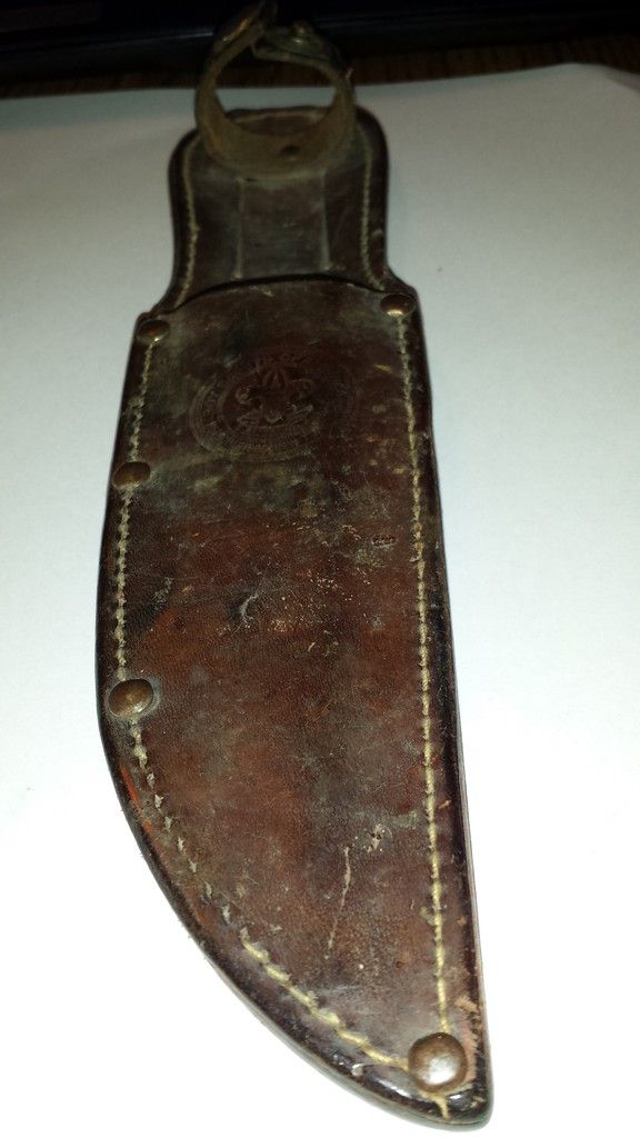

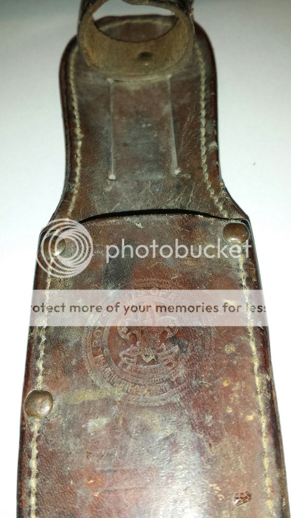

Based on the # of rivets on the sheath, assuming the sheath is original to the knife, eliminates another one (it had a 4 rivet sheath).
So were down to 7. Maybe even down to 4 or 5, as the blade looks too long to be 1 of the 3 shorter knives.
Well, dingle-berries.
While waiting for answers to my request for more info, I kept digging and comparing the first pics w/ my info, which is not complete by any stretch of the imagination. :(
I thought I had it down to possibly 2 knives based on the sheath stamping. It looks like the ring of words around the first class emblem includes the word "HEADQUARTERS NEW YORK CITY".
According to "600 Boy Scout Knives", which by the way, the author warns is probably not complete, this sheath stamp is rarer that the regular stamp, which is "NATIONAL COUNCIL NEW YORK CITY" and was only associated with 2 of the KABAR line knives. The problem with that is the 2 knives had 3.38" and 4.5" blades. So the first MINOR glitch in the giddy-up - sheath stamp doesn't match published info. But wait, there's more.

Your knife does NOT appear to be shorter due to re-profiling due a broken tip, so that's not an excuse for it to be THAT short.
Except for OAL, it matches a 1553.
It COULD be a short bladed 1553 (I doubt it - it would never have left the factory over a half inch short).
It COULD be another commercial Kabar model stuck in a BSA sheath - either being one of the many "unofficial" BSA knives, or being a Kabar knife stuck into a BSA sheath from another company's "Official BSA KNIFE" offering. The sheath does match the description of the BSA logo stamp "placement" (high up near the throat), but NOT the stamp that is supposed to be on the 1553 sheath. Well, stamps could be used on any sheath, depending on how harried/lazy the sheath stamper was that day. :D

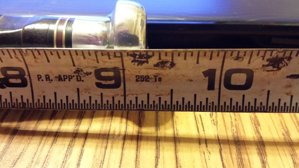

Thank you for all your help,I got it out and measured it again-I guess it is close to 9.25 overall
Assuming that it is a BSA model, 9.25" oal 5" blade w/ fancy snap ==> post-WW2 1946 to 1948, the last years that Union Cutlery/Kabar made Official BSA knives (per "600 BSAK"). The BSA model number for these knives is not included in the book, so we'll have to do a little "ad searching" in the Boy's Life Magazines for possible details.

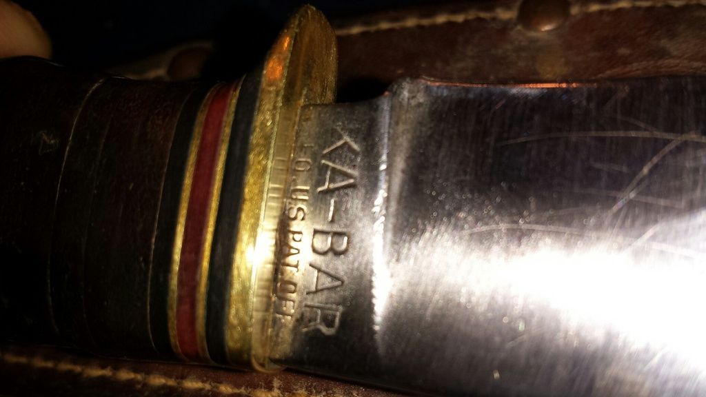

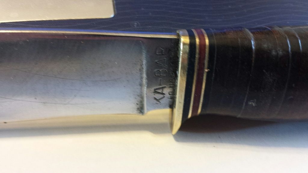

Also under the KaBar there is a couple of letters I can't make out,don't know if it is an EO or FO right before U.S. PAT.OFF.

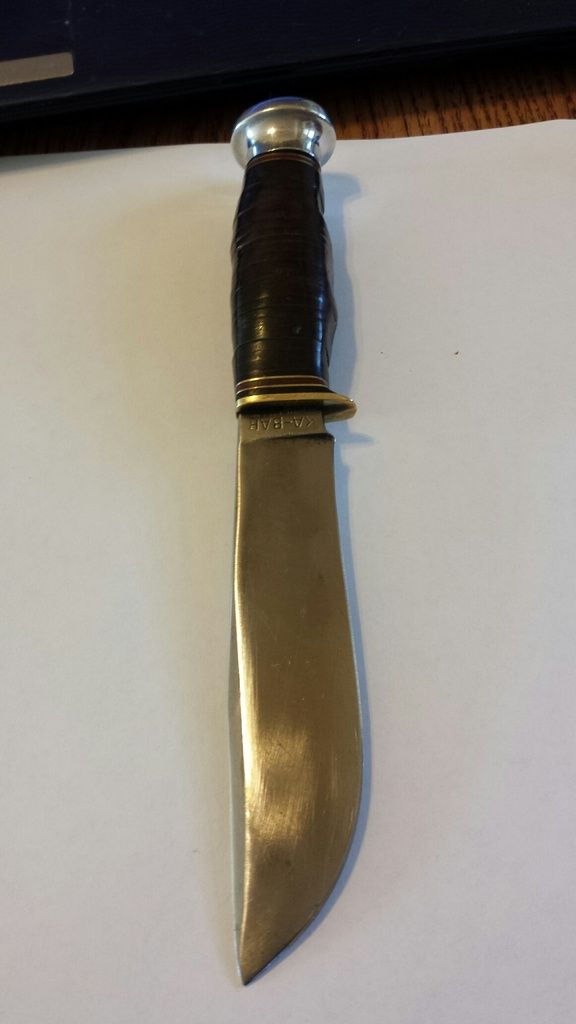

As far as I know, KA-BAR only made three models of official BSA knives. The little 3&1/2" blade stainless Little Hunter pattern, the rare Sea Scout rope knife type with wood handles, and the 598-5 pattern which is what we have here. I have no idea where the guy with the 600 BSAK book got his info, I wonder if he noted the different lengths of the 5" blade knives without noting the different pommels. The 598 pattern was available during the war years with the steel pommel which would make a 598 5" blade and steel pommel have a shorter overall length than the 598-5 with the aluminum pommel. Being as Marky's knife has the Reg US Pat Off mark I would say it has to be before 1943 and with the aluminum pommel before 1942, and I believe it was first available in the 1940 BSA catalog. This would give it a fairly close date of 1940-1942 only since they stopped using aluminum pommels in 1942. As to whether it is actually a BSA knife is impossible to tell since it has been heavily cleaned and there is no BSA etch left. I also believe that it is shorter than 5" simply due to the "cleaning". Many knives will vary 1/8" or so either way, but this knife was made at 5" originally. Many many knives have had switched sheaths over the years, and although I believe it is the correct knife for the sheath, it is not a provable fact. As to the sheath and it's marking, I have many and have seen many more with the "NC NYC marks and don't think they are rarer than those with the other marks, but it is possible that since I live in N.Y. state that I find so many with the N.Y. mark. The 1553 model number is a BSA catalog number and not a KA-BAR model number.
Thank you gentleman-very good info,I appreciate it,I know you can't talk values to me-but is this one to keep put up or use?

I think the guy who did that book was "smoking in the shower". He doesn't mention any official BSA etch on the Olcuts, it sounds like these are knives found in BSA sheaths and not from old catalogs or magazines. Ditto on the one with a retailer's etch along with the BSA etch, this would not show in a catalog or magazine picture. This would also explain why he has so many different length knives with odd measurements listed. He is using found examples, not actual catalog descriptions and some of his found examples are not official BSA knives (the Olcuts), and some have odd lengths due to cleaning or modification. Another proof of the lack of reliability in his book is the fact that the Olcut brand was phased out before 1937, the date he gives for Union Cut's first BSA knife.
Markymark, I would call your example a good user, most collectors want to see the official etch remaining to call it a BSA knife.
