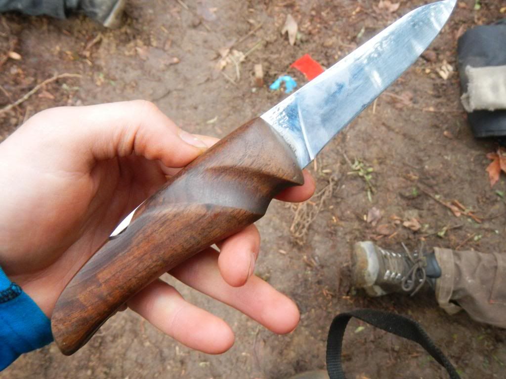

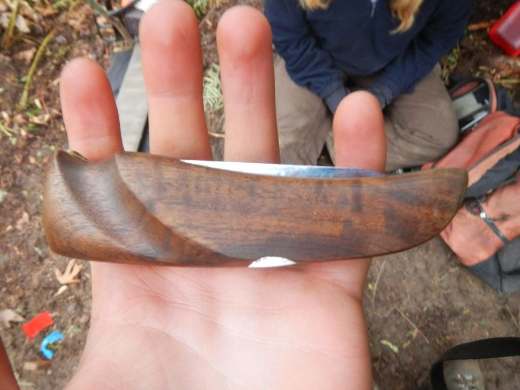

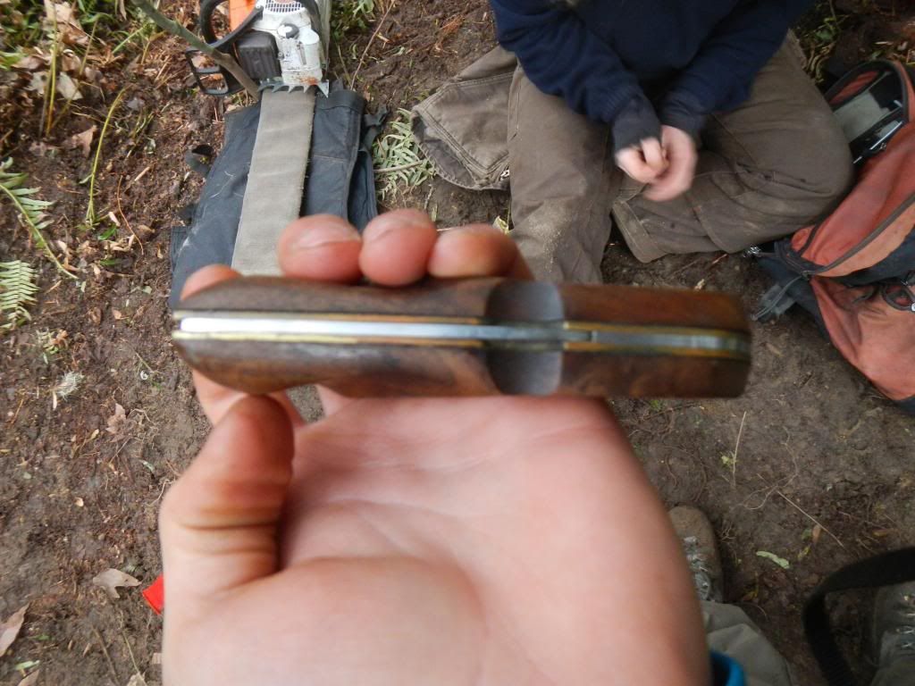

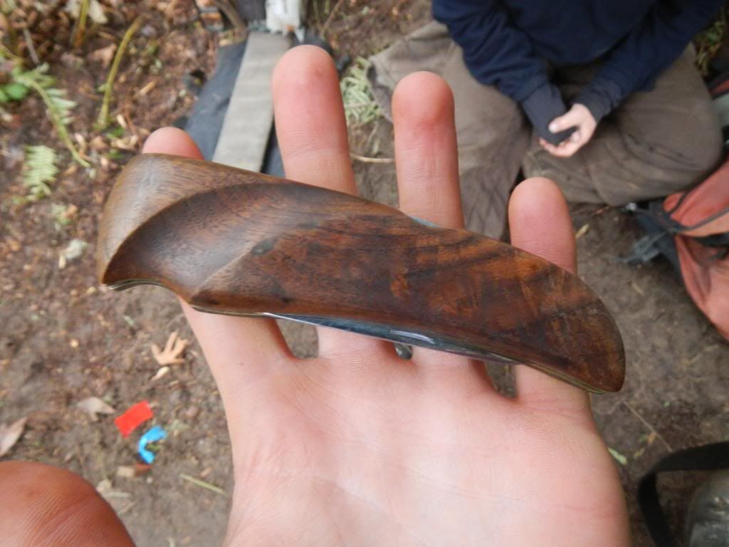

Hey guys, my boss has an old Gerber folder (shown below) that has been very well used over the years. We build trails, so our tools are constantly covered and filled with grit and dirt, and away from home up to 8 days at a time. It is a lockback, and is now VERY stiff and difficult to open. Any ideas on how to get the knife back to good working condition? My suggestions to her were: Air compressor to blow out grit, water wash, and then lubrication. Can you guys think of anything else to do? I would take it apart, but I have no idea how, as the wood scales have no visible way of removal, etc.

Warm, soapy water. Open and close it under water. Rinse, thoroughly, repeat if necessary. Dry well. Oil the pivot.

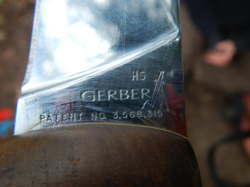

I would suggest to take good care of that knife, as it looks to be an early Gerber FH model (don't know if that stands for Francis Ham or Folding Hunter) with walnut handles, although the point seems to have been ground/altered.
The blade also has the HS marking which stands for High Speed (steel), in this case M2 steel with a hardness of around 62 HRC.
Stainless blades were marked with an S only.
If you manage to get a good edge on that blade it will hold it for quite some time (if used as a knife)

My recommendation, oil the pivot and work it loose to try to knock loose the gunk before you scrub it to make life easier. Than dawn + toothbrush or paintbrush with strong bristles if the toothbrush doesn't reach far enough and scrub, rinse. Work the pivot under the water and more dawn + scrubbing. Dry and oil.

Nice knife! That's a folding Hunter as previously mentioned. I thought the HS marked ones were L7, but I could be incorrect. There were versions without checkering the handle, I've owned about six of these in total. Either way; that's a pretty collectable knife, even with the blade in that shape. Here's what I did on mine: get a can of wd40 with the straw and with the blade partially folded spray into the pivot area from the top a little at a time and prevent contact with the wood as much as possible. Work the blade back and forth until you see some of the dirt coming out. Repeat until you feel a difference. Add a drop or two of a lubricating oil (I use mineral oil); the wd40 will eventually evaporate form the pivot. It's a slow process but it worked for my FHs. Hope this helps!
