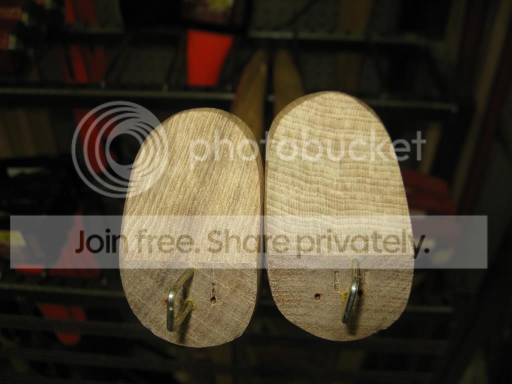

I have been attempting to improve my handle selection skill set.... as such,
trying to develop a mental algorithm for assessing quality of handle material
available. At the risk of looking like a fool .... I present to you a routine bargain
bin handle (I picked up recently for $5.00).
To my best current knowledge (gleaned from interrogating this forum archives)
I looked for...
10 point list.... (not all equal weighting).
-reasonably diagonal growth rings
-minimal "run-off"
-minimal knots
-5-20 growth rings per inch (not sure where on handle to measure)...
-no cracks/splits/fissures
-thin handle
-straight handle
-(vague) how it feels in my hand
-2nd growth (but unclear on how to assess this)
-no lacquer
Please critique and share insights... my ego was parked long ago.
Charles
https://imgur.com/a/Jrt2o
I'd be happy to use that handle, for sure.
No flaws I can see in the pictures that would matter.
Vertical rings would make it ideal.
That said, I have put a lot of work on way worse looking and they held up!
...growth rings per inch (not sure where on handle to measure)...
Look at the knob/ swell end of the handle.

I can't tell exactly how much runout you have there. I want to see at least 50% of the grains in the eye also present in the swell. A great handle will have every eye grain present in the swell. A grain may disappear in the thinner portion of the handle but then re-appear in the swell.
Be weary of rules because wood is so unpredictable. Funny I never see mention of the trick my grandfather recommended, holding the handle just off the floor and let it bounce, listening all the while for a clear sounding resonance on the rebound. Compare the handles at hand and pick the best sounding one out for further interrogation. Of course this precludes any idea you might get to do your shopping on those lines.
It looks like it has some fairly significant run out but otherwise looks good. This would keep me from buying that handle, but it would not keep me from using it if I already own it. Use it and just be aware and watchful.
Ernest, your sound test is a good way to reveal punky or spalted wood. Sound wood makes a clear tone as I'm sure your father knew.

I still need to learn how to spot old growth v. new growth v. 2nd growth.
Actually you don't. The key characteristic of second growth wood is growth ring spacing. Second growth wood tends to have been grown in previously cleared woods where it grows faster and has less growth rings per inch (likely in the 5-20 gr/i area). Whether the wood is old growth or second growth really doesn't matter. What matters is the gr/i, the density, the straightness and the soundness. Second growth tends to grow straighter in cleared woods. But old growth might still exhibit very straight grain.
