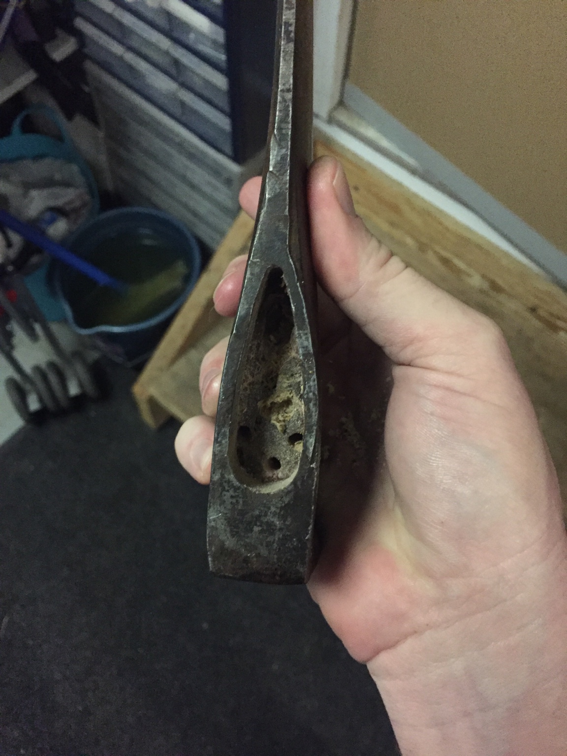

I have an old cedar axe head that I can't get pushed out. I've trying knocking it out with a punch. Drilled holes to weaken it. I need a new plan. Any thoughts?

I'd say a few more holes -- especially along the front and rear edge and possibly increase the diameter of the ones you already have.
Drill more holes lots more holes, till it looks like Swiss cheese!
Yep ^ after awhile you can wiggle the drill around and connect the holes, then use a old chisel to get the edges. In takes some time.

The top of the eye is bigger and the wedge spreads the wood out, it's never gonna fit through bottom of the eye.
Hit it through the bottom and out the top, if you had done this in the first place it would've come right out in under a minute 👍.

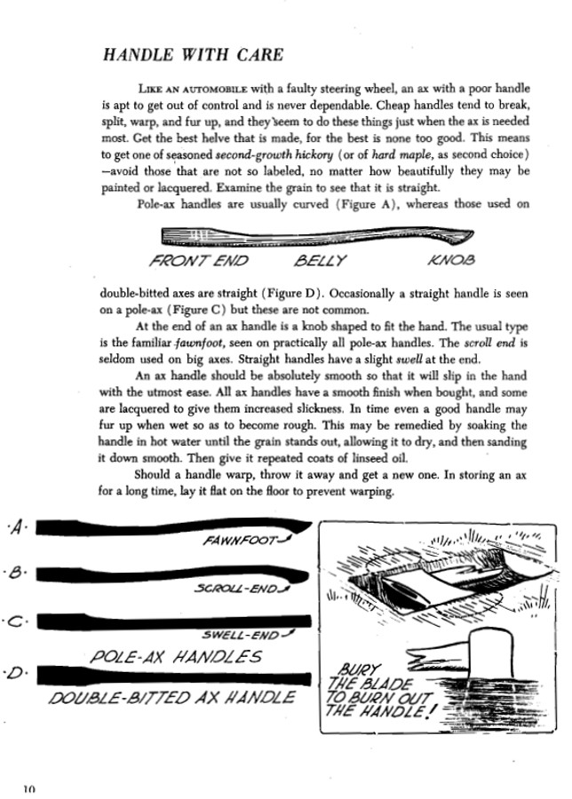

In a pinch you can dig a small hole and fill the bottom with damp soil, burying the bit. Then build a small fire over the top to burn out the eye. Of course if the soil dries during your fire you still risk ruining the bit.
From Woodmanship by Bernard Mason;

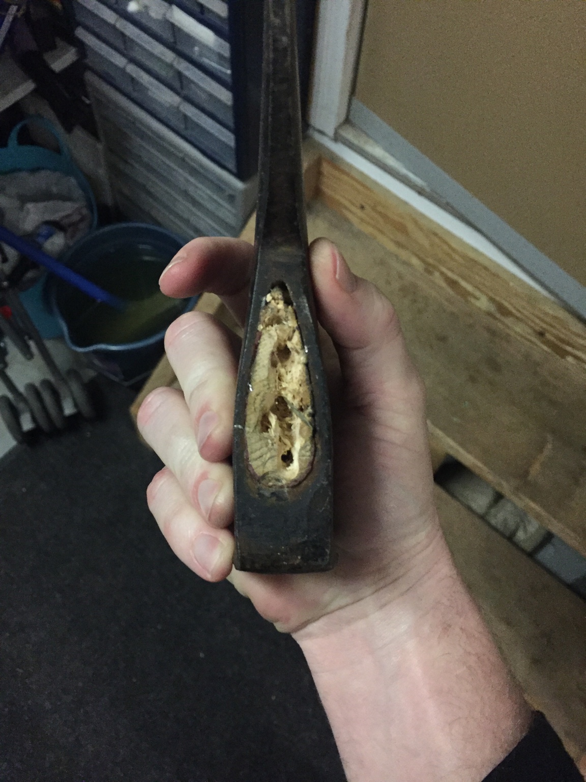

If this picture means that there is some sticking out on the other side (in your palm), stick it back in a vise and cut that off flush with the eye.
Flip it over and drive the now cut off piece out the way it came. Rinse and repeat until you can possibly loosen the wedge up and pick/chisel/drill until you can get the whole thing or even part of it out.
If that doesn't work then you just have less for your drill bit to eat at while trying something different.
Also, If you have the handle it came off of you can cut it off, shape it into a punch, and try using that - try to cover as much of the eye as you can without making contact to the eye walls. A good solid wooden punch can be handy on others as well.

You make an axe eye shaped drift from an old piece of hickory (or better yet, steel) and drive the old wood out from the bottom to the top, you can't be stopped. I don't waste time with any other method now. It's been a long time since a stuck handle gave me any trouble. You'll need a hole to drive down into, but the top of an open vise works fine. I do advocate drilling and swearing though, for sure.

Try going to the bottom of the axe head, where you cut off the handle and knock the remaining axe out from bottom to top direction. Many of these axes had tapered eyes that prevents the wood from being knocked out from top to bottom. Knocking out the wood from the bottom through the top is the way to go.
