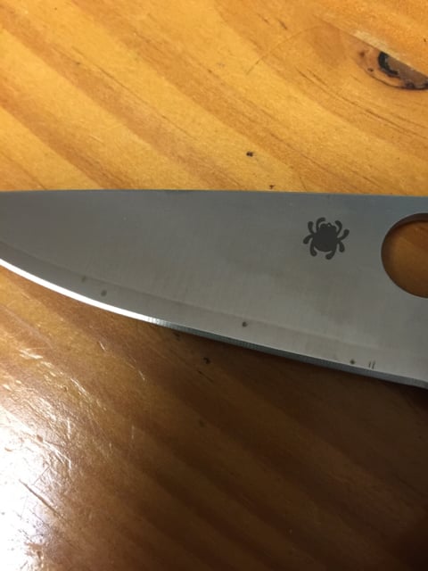

Any suggestions on how to remove rust spots on HAP40 steel? I cut some watermelon w my Endura. Washed and wiped it afterward but apparently I did not do a good job.
Any advice? Thanks.

Yes. One time! First time the knife was used was on the watermelon. Would Spyderco provide waranty coverage if I am not the original owner?
My advice is to enjoy using it. Continue to wipe after use, rinse if you want. What you see is normal and won't affect performance at all.
Carbon content is pretty high in that steel, about 30% higher than 1095, for example. Aside from adding hardening potential and wear-resistance (in combining with carbide-forming elements), carbon tends to act as a catalyst for oxidation/corrosion in steel, so I'd expect it to patina pretty fast, with the steel not having enough chromium to offset it. No defect or warranty issue there, as steel of this type should pretty much be expected to oxidize, with black oxide 'patina' or red rust, or more likely both to some degree at times. So long as you don't let it get entirely out of hand by neglect, there's little reason to worry.
That aside, those spots look, at least in the pics shown, like simple patina (black oxide), and not destructive red rust. To make sure, you can rub the spots with a white pencil eraser and look for red/brown coloration coming off. If you don't see that, don't worry about the spots. And even then, if you do see some red/brown, just scrub it with some baking soda, which will dislodge most/all of the rust, and the black/grey patina will remain. Then keep it clean & dry after each use and oil it if you think you need to.

Thanks for your thoughts. I don't mind the cosmetic changes, was worried about the destructive rust.

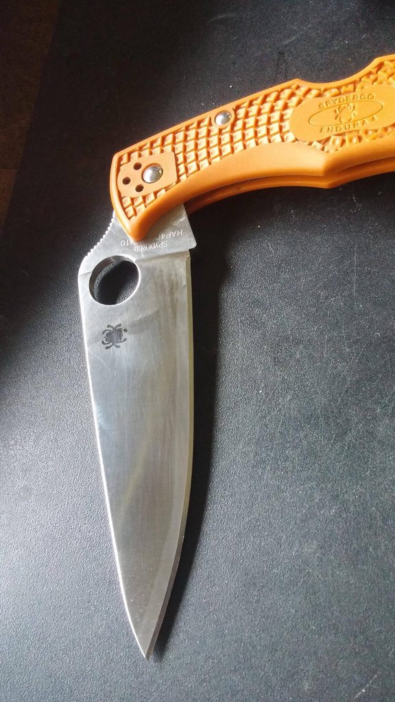

Ha bad luck for you, that's pretty harsh! I had a lot of light scratches on it with a few darker spots but nothing like this, and I use it a lot for cutting fresh veggies in the garden. And I mostly used to just throw it under the tap to wash it and air dry haha
I removed as much sctaches as possible with a light cloth buffing with some green compound and oil on it, and darker spots disappeard, and it was like the knife was drinking the oil.
As you can see, lot of scratches but no spots. 3 month daily use.
JB...it is your assumption that I was seeking a replacement. My warranty question was about getting it serviced and pehaps rust remove. I am more familiar w Bechmade where they sharpen the knives and do a nice job cleaning it.
As for the knife, I took the advice of using an eraser. No red stuff came off so no concern about destructive or deep rust. I then used some toothpaste with the eraser to polish the affected area. Most of the rust color came out but dark black spots remain.

That's not rust, that's just patina. Perfectly normal and that's to be expected of a knife steel like hap40. If you plan on using it, then expect for stains to appear. If you're looking to keep a shiny blade with low maintenance, then perhaps hap40 is not for you.....
