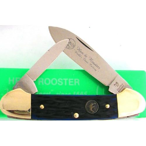

Hi guys,
I am not a connoisseur like most of you are around here therefore wanted to ask you about a Hen and Rooster canoe knife, blue bone, that I was able to get a couple of months ago. It has Solingen stamped on the big blade and is stainless. The previous owner told me that the blue bone is real bone, but I am not sure.
I had been looking for a canoe for some time but did not wanted to spend too much money on it. The knife is intended to be a user, carrying it two or three times a week.
So my question: How is the quality of Hen and Rooster knives? Is this blue bone real bone or is synthetic?
Thanks + Regards

If this is the knife, the online vendor info states that it's bone.
+1 to what Elliot said. With experience, you might also be able to do that 'skate test' with your fingernail. Plastic or delrin is very soft, so even a fingernail might dig in or scratch it. Bone is quite hard, so a fingernail will skate across it, if you attempt to scratch it.

The knife that I got is exactly the same that Blues posted in the picture.
