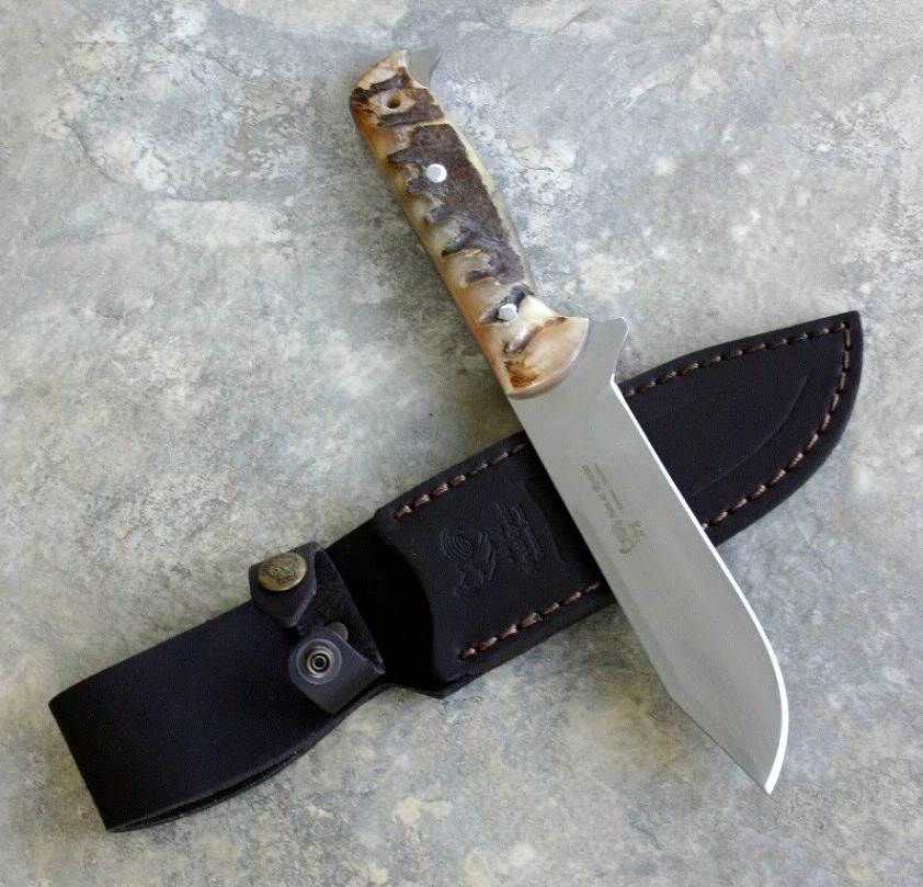

Sorry to hear this, but I have to disagree in part. Not all of their knives are made in this slipshod fashion. I have several of their ram's horn full tang knives, also made in Toledo, Spain, and they are brutes. Heavy full tang construction with massive pins, thick covers and excellent German stainless (the equivalent of 440B or C). They take a nice edge and sharpen like they are around 58 HRc (never had one tested). They also come with very nice 7-8 oz. leather sheaths.
Hunter, 8"
e8e3897b-82a0-4586-a032-5339d2ab830f_zpsc17a9732.jpg~original
Gut-hook Skinner, 7"
c85b0ecd-a0dc-4953-93b6-33ffc1833a7c_zpsa28fc985.jpg~original
Utility Bowie, 10"
5035RH.jpg~original
Even companies with good reputation will do things like this. I re-handled a Muela and after taking off the scales found out that same type of tang construction, small tang riveted to a cast metal extension. But these are on their low budget knives; if I don't see the nut at the pommel I don't buy it. I have disassembled many of them and if it has that nut at the pommel, it is a rat tail. The cheap ones have a solid pommel connected to the frame and guard, bad stuff.
