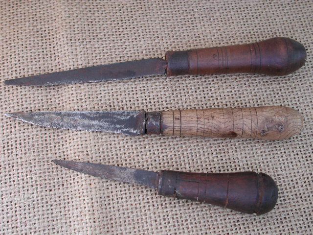

It's called a Capouchadou, and it was the everyday work knife of farmers, shepherds, and other humble folk in south central France during the latter part of the 18th century, early part of the 19th century. As humble as their owners, these knives had simple wooden handles, turned no doubt on a spring pole lathe, with a bolster that consisted of a metal band that kept the handle from splitting. The blades on all examples I've seen, are fairly straight and fairly pointy, and were used for everything from slicing bread, to slaughtering sheep, to self defense.
I figured I'd mention this wee "peasant's dagger", because, like a puukko, it's a very uncomplicated style for a beginning knifemaker to try his/her hand at. You could even make a very quick, and fairly authentic looking one by purchasing a good quality wooden file handle from just about any hardware store. Take it home, deepen/widen the tang hole, and sand/refinish as you like.
Anyhow, here's a good picture of the knives I'm talking about from a museum in France;

Good eye 45-70, it's my rendition of an 18th century piece. Spent some time chatting and comparing notes with the blacksmith at the Old Spanish Quarter living history museum in Saint Augustine, Florida. He's an avid knifemaker, loves the old "colonial trade" styles, and had one of these in his belt and another one he was working on. I was so smitten with how comfortable and secure this handle style feels in the hand, that as soon as I got back to Texas I made one for myself lickety split. It's now hands down my favorite, that is, until I get around to making one with a bone handle instead of Honduran rosewood. ;)
Sarge
A matching pair, one with a piercing blade like you show and one with a curved skinning blade...
It might be because of their age . The handles look stronger than the blades . Maybe its because they,ve seen lots of use .
