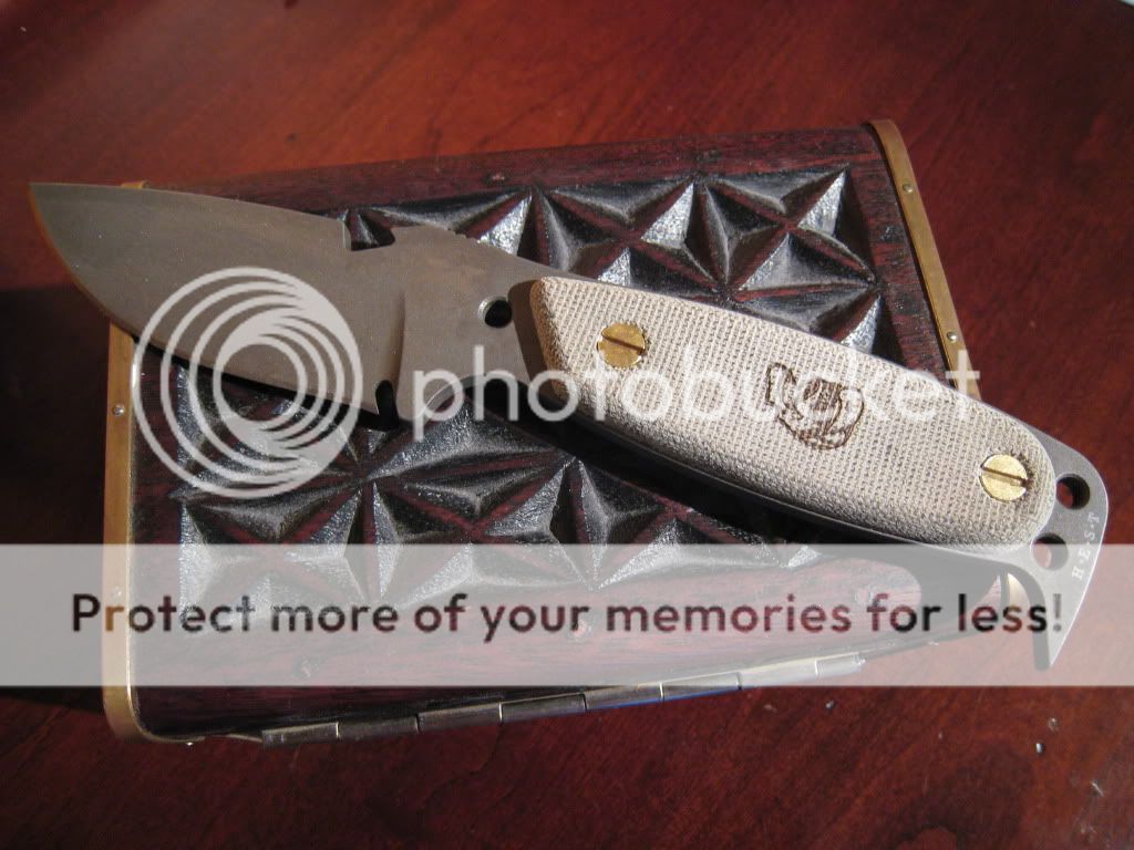

So, I finally got my HEST. First things I noticed was how well it sat in my hand- I was a little worried about the bottle opener feature but everything fits well (I would say I have average sized hands- between a medium and large in Mechanix gloves if that helps anyone). Second thing I noticed was how badly the knife smelled- hopefullly this will go away with time, my brother says his did. The skulls are cheesy and a bit lame so at some point I'm going to end up doing my own micarta handles. But, I was really surprised to see how much room is actually in the storage "compartment". Very nice feature. Nothing to add from a usage standpoint so far except that it does come shaving sharp out of the box.

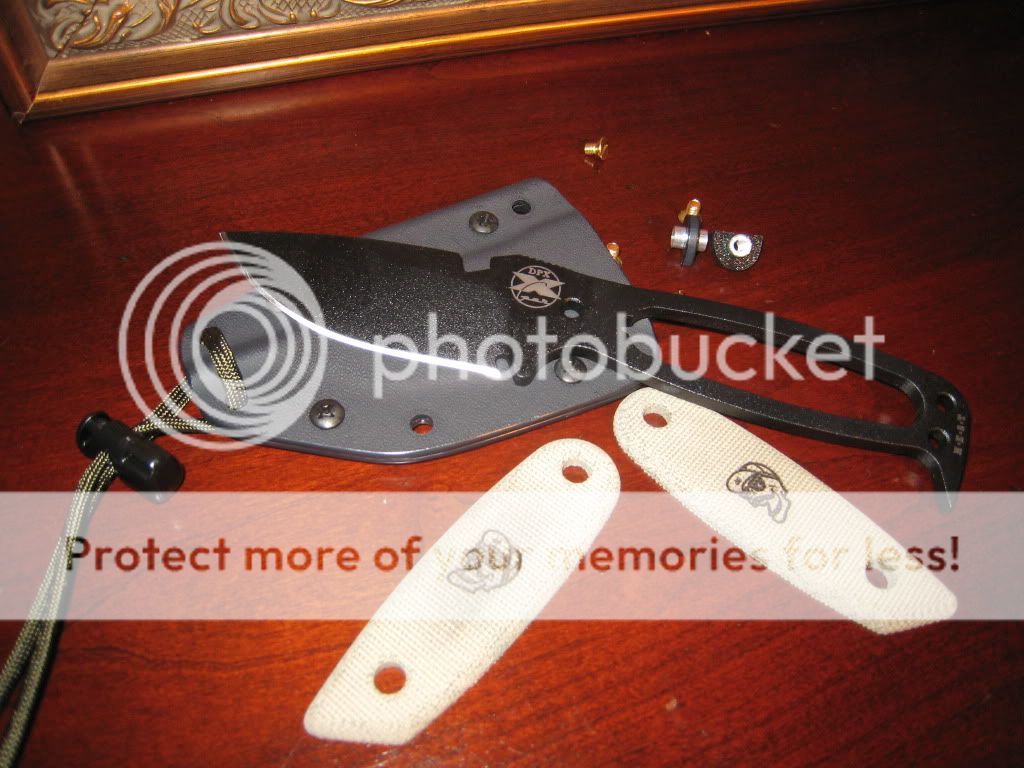

Anyway, I decided to do a little work on it. I was inspired by NEMO to strip it but it ended up being a bit of a process. Total time was about 12 hours or so.
Scales come off first...

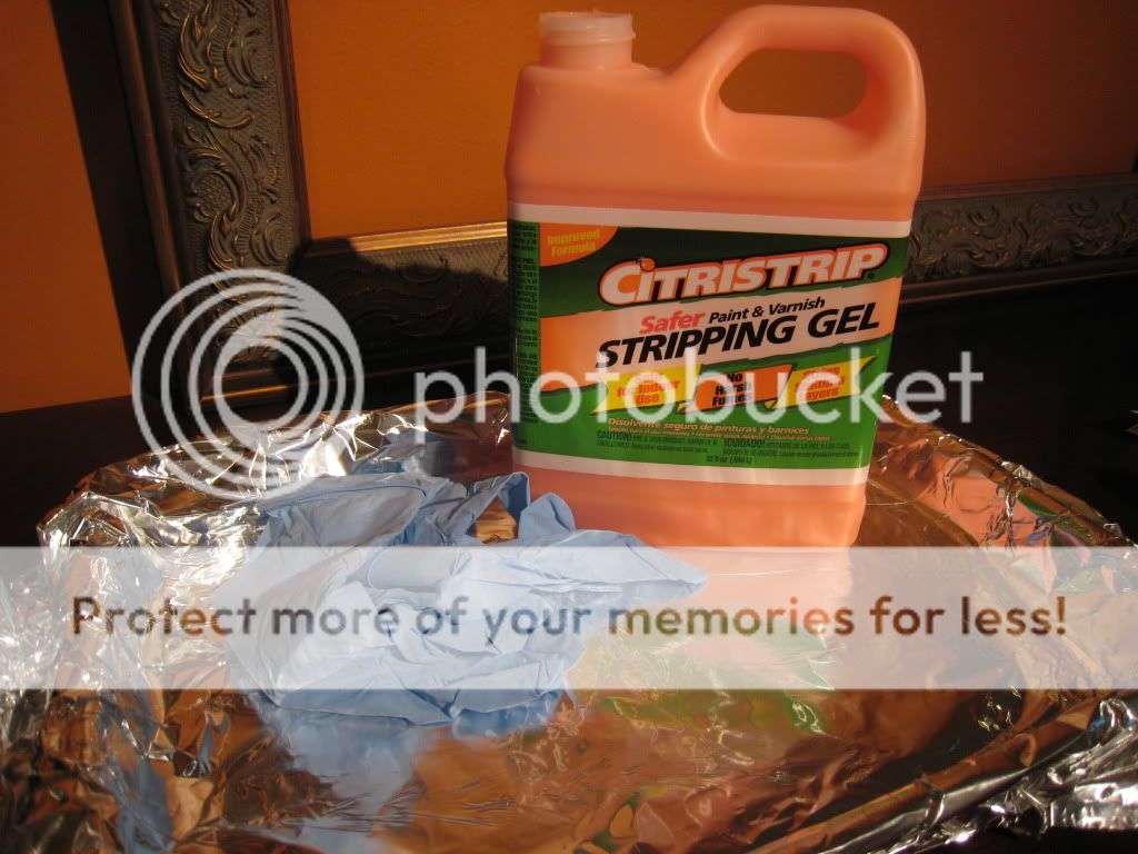

I used Citristrip paint stripping gel because that was the only thing they had at the local Home Depot.

I wiped the blade clean just in case there was any residue or whatever and plopped it down into the gel. I planned on it taking 30-45 minutes based on NEMO's process so I waited...

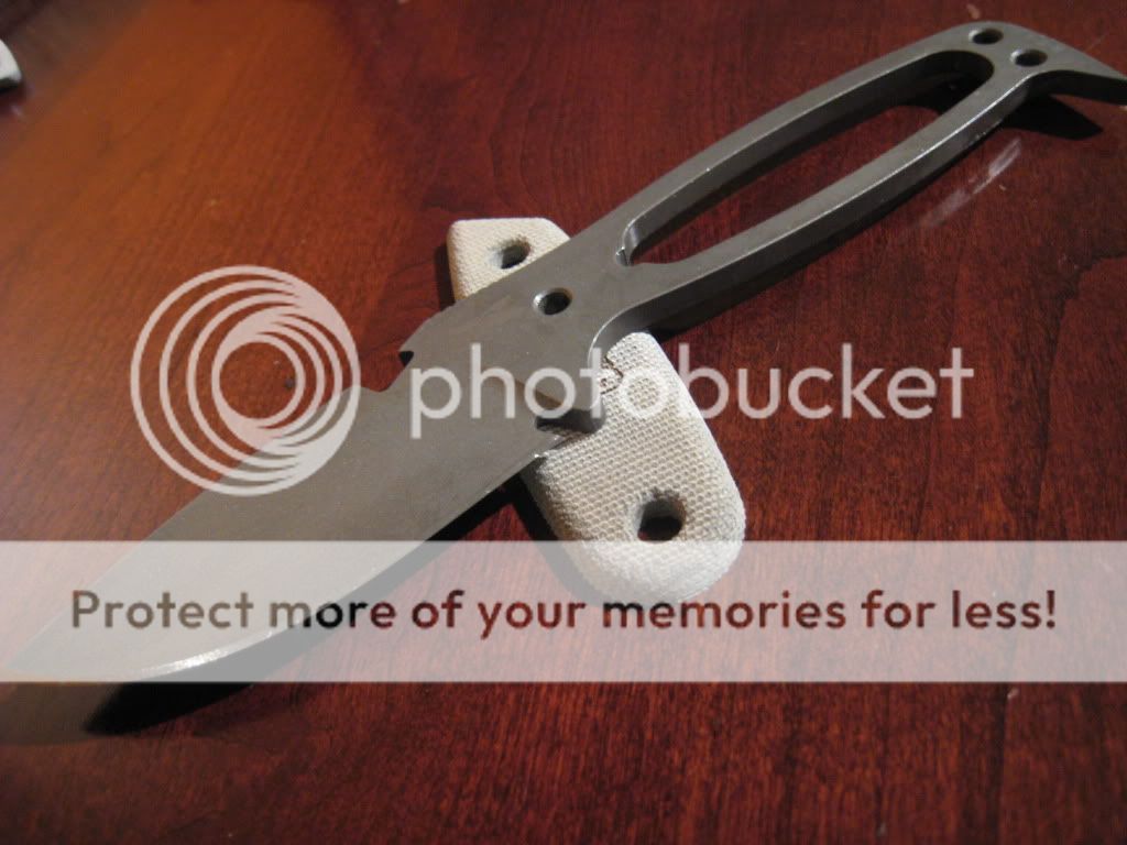

30 minutes later I unearthed the hunk of metal and did a little scrubbing with an old toothbrush. Nothing. So I grabbed a non-scratch scrubby and did a little work on it. Nothing. Back in the orange goop for another 45 minutes. This time I went straight for the scrubby and had a bit of success.
http://i985.photobucket.com/albums/ae340/britchcock/BladeForum/IMG_5227.jpg
Repeated this process again, this time leaving the blade in for 2 hours. I was able to get most of the black off but the hard to reach places continued to put up a fight so I put her back in the gel. This time for 6 hours straight. After getting back from work i was able to take off the rest with a q-tip, chop stick, and my thumbnail (go figure).
http://i985.photobucket.com/albums/ae340/britchcock/BladeForum/IMG_5235.jpg
http://i985.photobucket.com/albums/ae340/britchcock/BladeForum/IMG_5237.jpg
Overall, I'm happy with how it turned out. I'm not a DIY kind of guy, but I had a lot of fun with this. The knife feels dryer if that makes any sense. The blade is more grippy now and it looks a bit older and more rugged. Straight business. I'm going to keep a close eye on the rusting issue and see how it reacts after the strip. I'll attempt making the new handles in a couple weeks... we'll see how that one goes.
