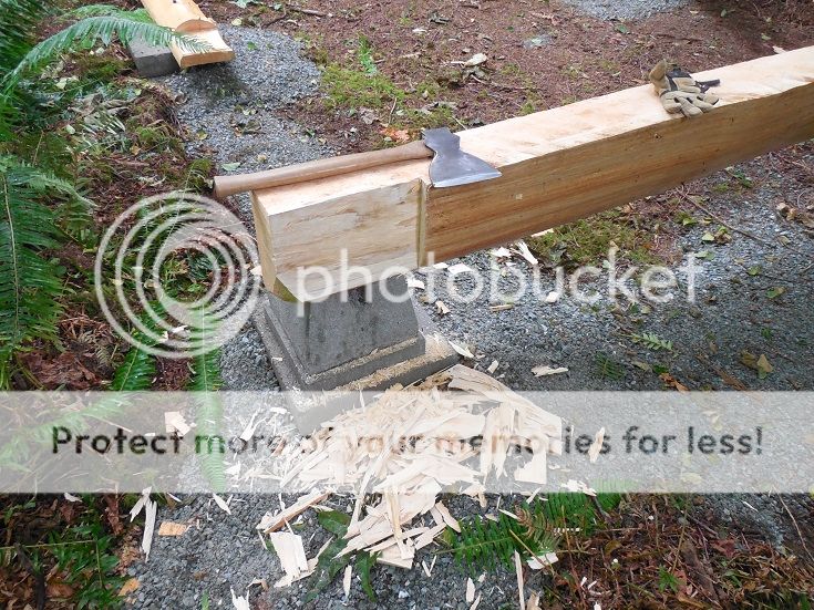

Very clean looking work, Alocksly!

Beautiful axe Alocksly!
