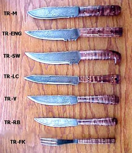

Some classic examples, from Ragweed forge. TR-RB is listed as a Roach Belly, with TR-V being its bigger cousin.

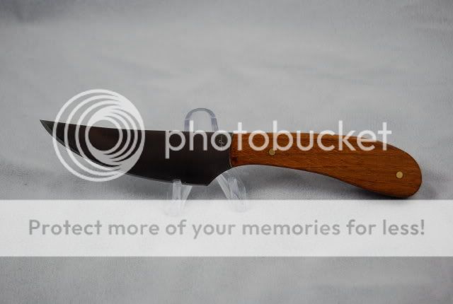

This one's by North River Custom Knives - their interpretation of the Hudson Bay Roach Belly.
I gather that the general description is a small-to-medium all-purpose knife with a decent point, a bit of belly, and a rounded handle.

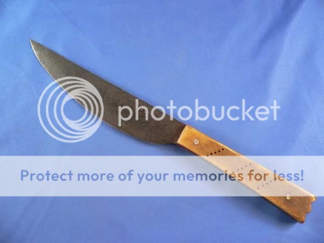

Not sure of the history of the Roach Belly, and can't seem to find much. Hudson Bay made some. The first pic is a Hudson Bay Roach Belly. Basically the blade edge is a continuous curve with no straight section. The whole blade is belly, typically a straight back or a very slight upsweep to the blade. Common to see them with the up swept blade and a counter sweeping bulbous handle, so it has a slight S shape to the whole knife. I REALLY like the Hudson Bay Roach Belly.
Hudson Bay

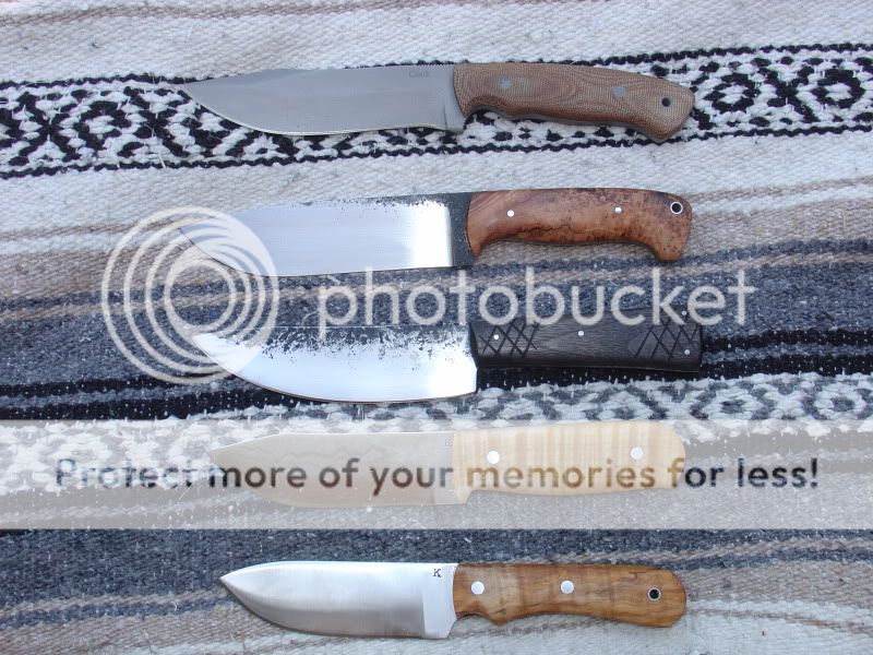

I guess the ML (Third knife down) could be considered a Roach Belly....a really big one)
