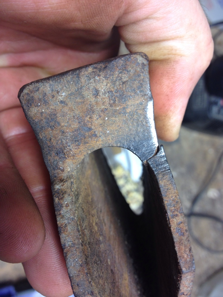

Hey, y'all wanna see my axe crack?
Jul 25, 2016
101
I was thinking of cutting and making a pickaroon and Hudson out of it, but I'd rather grind it out and weld. I've read about the heat sink wrap on the bit. Any other advise. Otherwise this is in pretty good shape. Very little mushroom.
Nothing to fear welding that far from the bit. I had one welded toward the front of the eye - zero issues at all.

Should I just grind a notch in or cut through the crack, drill a hole at the end of the crack to stop it from growing, and ever so lovingly try to tap the cheek back in before welding?
Drilling the end of the crack is normally a good idea.But if you'll burn it with the rod,nice and hot,it'd probably not be critical.(If you have reservations about welding it,just do so with the axe sticking out of a coffee can filled with water to above the bit level).
Look at the grain inside the crack,if not too corroded,can you see,with a naked eye,the individual grains?If so,then chances are that the entire axe,or it's poll at least,is embrittled thusly(a by-product of an improper HT).
If you Really cared for this particular axe,you may want to re-HT the thing,doing the proper Normalising cycles to control the grain growth.

Don't bother drilling. Just grind a V-groove and do try to re-align the crack before welding. Preheat and weld with 7018 if you have it on hand. But whatever you have on hand is likely good enough.

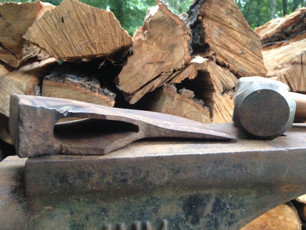

One other thought, the toe looks considerably worn. It may not be worth fixing. This is a good candidate for a vinegar bath just so you can see how much bit steel remains. In general the toe should be slightly longer than the heel.

All I have is 30 mig wire. Argon/C02

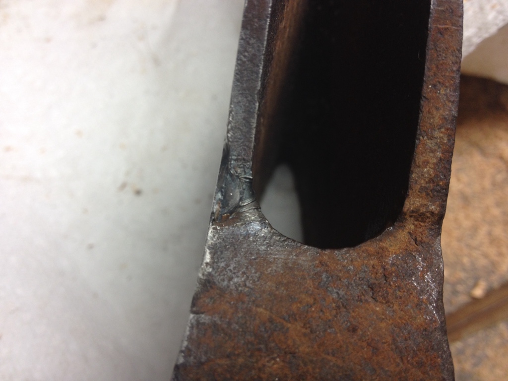

Lined up and welded.
The little notch in it is just were I got a little crazy with the file.
Almost looks like it could use a teeny bit more weld to fill in the bottom edge but maybe that's just the camera.

I think I'll go one setting hotter next time though.
