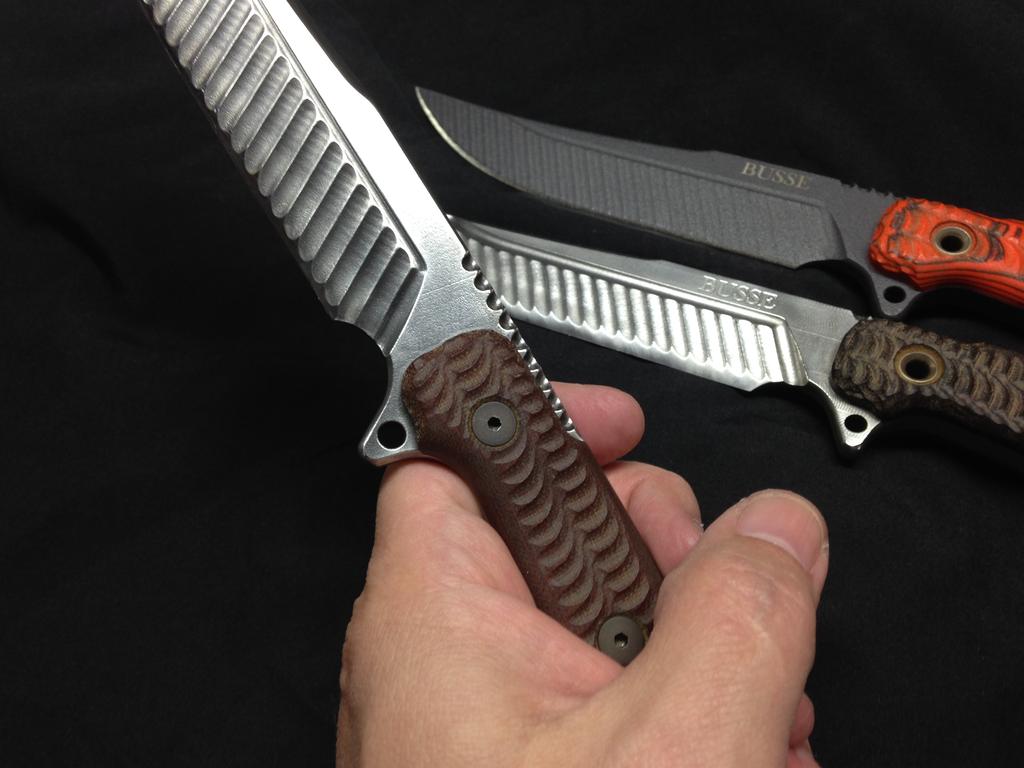

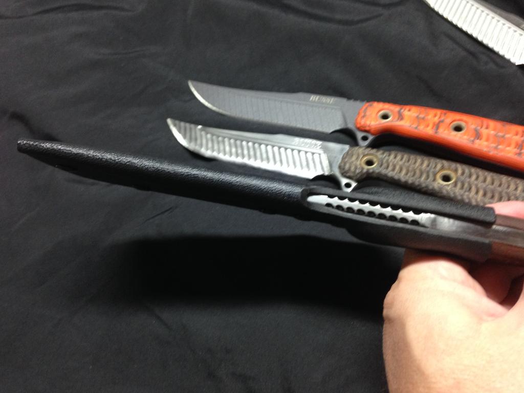

HG55 variety of "vertical" CBT, from top, "small" CBT, competition finish "large" CBT, comp. finish large CBT with "bomb-proof" tip, stripped Military Overrun with bomb proof tip:
"BUSSE" + competition finish + large CBT detail:
Large Regular CBT vs. large CBT on "bomb proof tip" convexxed by me:
"Small" v. Large CBT detail pic:
stripped bomb proof MO with tubes drilled out:
detail pic of spine in Ben Piatt custom taco:
