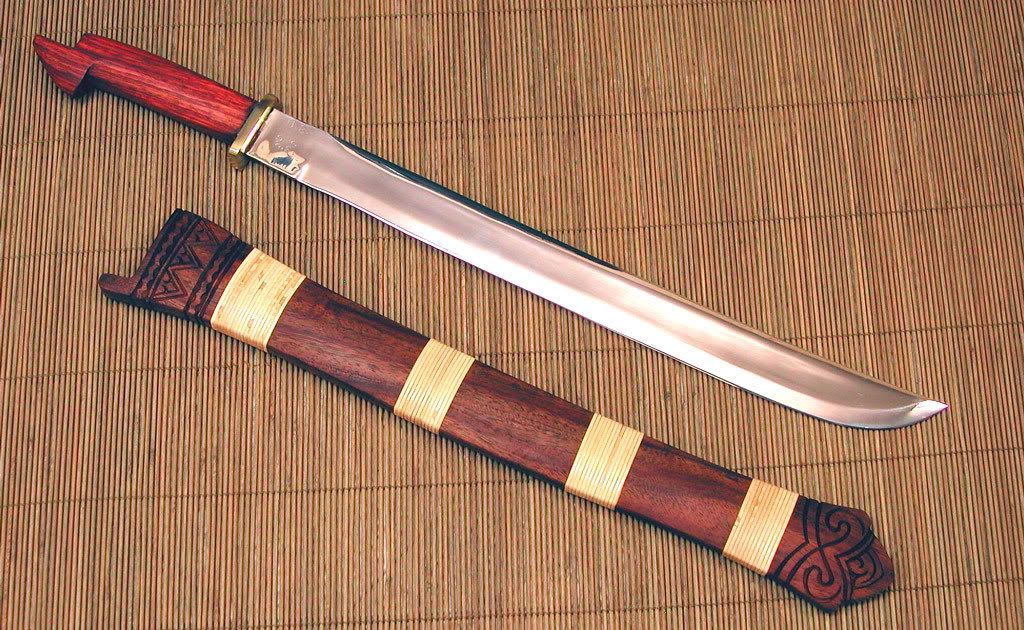

I was lucky enough to score one of Yangdu's DOTD ginuntings last week. The scabbard was broken, so I got a very good deal at $100. When it came, the scabbard was broken pretty badly, so I wasn't sure how it would turn out. Almost started over, but I'm glad I was able to salvage it, as the wood and carving is beautiful. And that's why I picked it. After maneuvering the pieces back into alignment, superglue was wicked into all the cracks and clamped. After it cured, a sanding and one coat of Tru-oil was applied. After soaking in for 10 minutes, all Tru-oil that remained on the surface was wiped off.

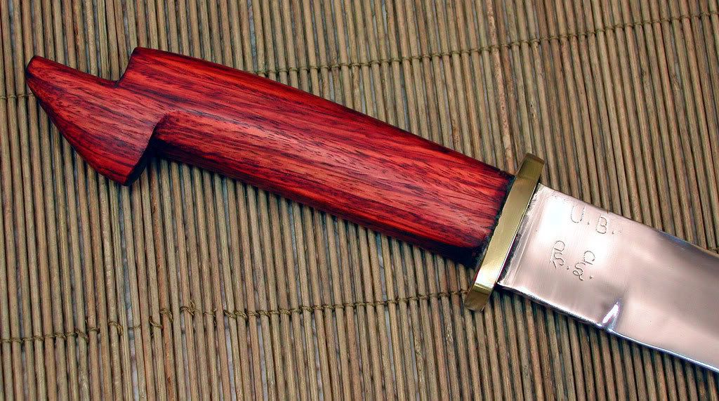

The beautiful octagonal handle was slightly reshaped so that the bottom of the grip was thinner than the top. This seems to be traditional for handles from the Luzon and Visayan regions of the Philippines. It fits my small hand better too. Again, one coat of Tru-Oil.
The brass guard was slightly reshaped, and given a satin finish with a Scotchbrite pad.
Philippine scabbards are often not glued together, but just wrapped with rattan. It's usually braided, but as I don't know how to do that, I applied 4 plain wraps of water soaked rattan. As it dries, it shrinks and holds the halves together well.
The blade required little work, just a convexing of the edge, and stropping.
This is a wonderful blade, and I felt lucky to get it. Can't wait to try it out against some soft targets!
The pics aren't great, as they were taken in the kitchen this evening.
