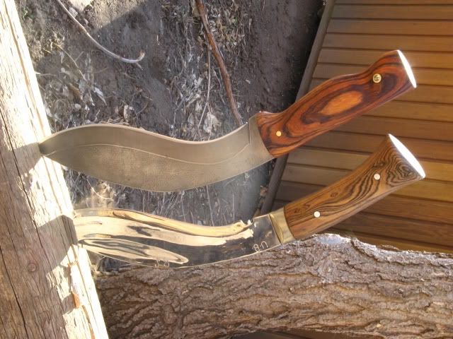

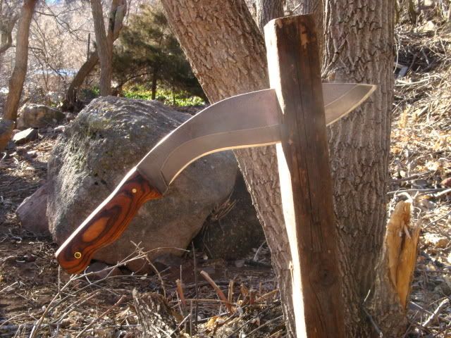

These 2 are pretty much the same size. I took them to the backyard for a little comparison of chopping ability. The HI is a Dui Chirra by Bura. The CS is the Ghurka Light Carbon V.
A big difference in thickness.

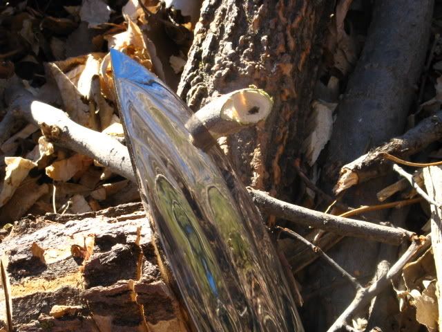

First I chopped some small logs in half
Winner Dui CHirra by about 20 chops.

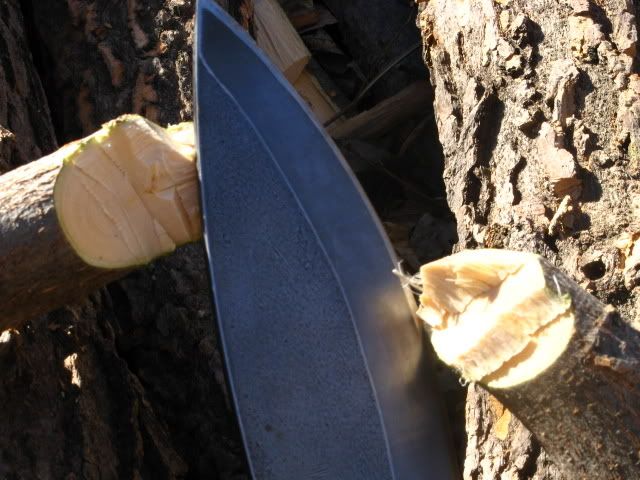

Next I cut some small branches.
Winner Tie. Stuff this size is no match for a blade this size.

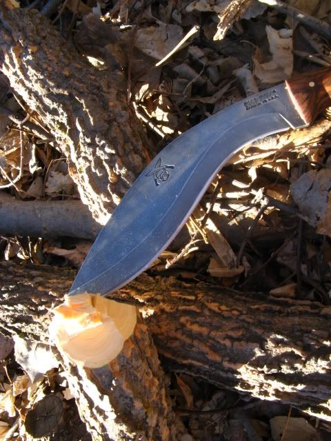

Next I cut some medium sized branches.
Winner Dui Chirra took 3 good whacks.
Then I tried to see how far I could sink them into a old 2 X 4.
Winner Cold Steel gets a little deeper. The thicker HI wedged itself in.

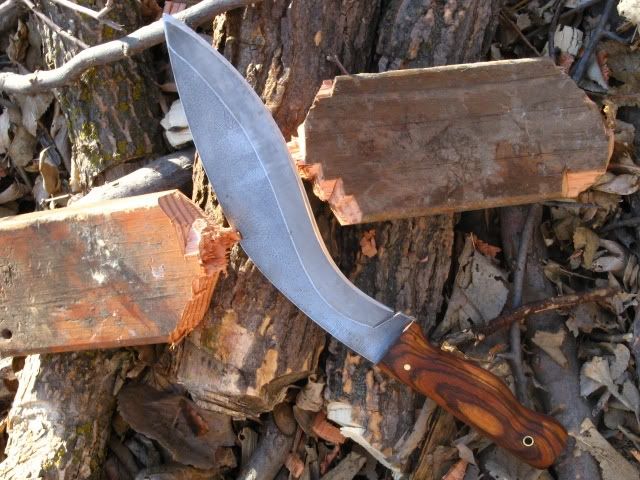

Cut some 2 X 4's in half.
Winner Dui Chirra by a mile.
Both knives have convex edges. I found that the CS was easier to put exactly where you wanted it but the lack of mass just can't throw chips like the HI. The thin blade also tended to get stuck, never a problem with the HI. Although the CS is much lighter and easier to swing it really doesn't matter because you end up taking more swings to accomplish the same work.
I have had this Cold Steel for years. With the new handle and convex edge it is much nicer than it ever was. But it still cannot compare to a HI khikuri.

thanks for the great review ilbruche, I can see the bites that it takes into that 2x4!
what, did it go through that in like 12 chops?
and how long is that kukri BTW?

Thats a hard old 2 X 4. Took a little more than 12 whacks. More like 24. I also don't have a good chopping block so my swing isn't as effective.
It's a 14" OAL.
I have several BDC's, but none of them have an awesome handle like that! The CS looks amazingly better as well. They are nice little blades, but the kraton can be a pain and they tend to stick in the wood unless they're convexed like yours is.

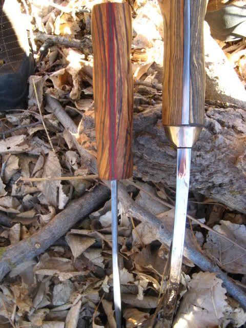

Where did you get the handle work done on that Dui Chirra? Did it come from HI like that? Almost exactly what I'm looking for.

My 6" by 6" by 3" thick block of Bocote wood arrived this weekend. I have cut the scales for the 18" CAK, R-10 and my old Legitimus machete so far. You never mentioned that when you cut it , it smells like wonderful olive oil dressing.
Have you ever considered using pins for the scales that protrude a bit on the inner thumb side, like on some khybers and kindjals.
Thanks for the help,
mark

ilbruche,
mark
It's a great wood. It doesn't really need any special finish. I usually just sand to 400 and buff without any rouge. Sometimes I'll give it a danish oil soak but the wood is so dense and oily it doesn't seem to do anything. A coat of Briwax never hurts.
