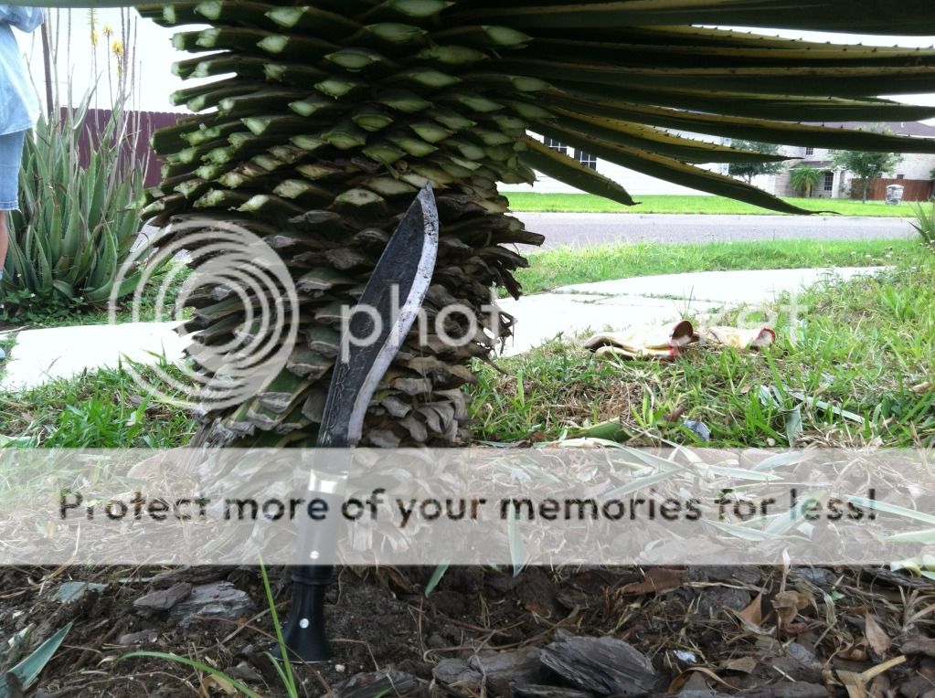

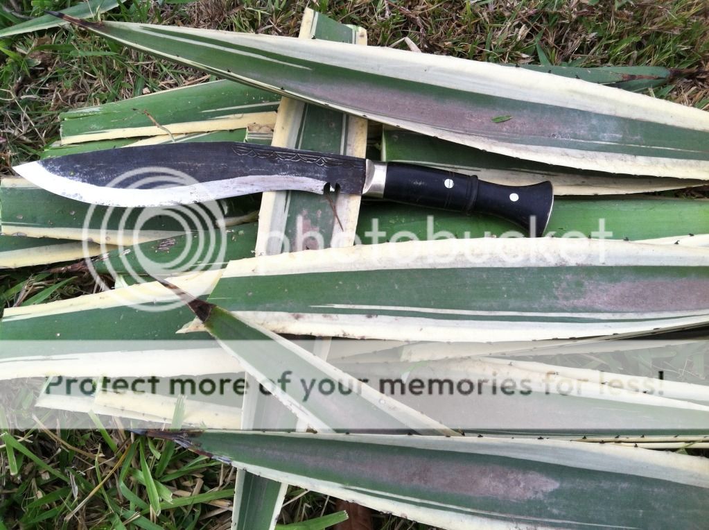

I had to trim up some big maguey plant's in my yard. They are very tough fibrous plants that have wicked needles on the end. Decided ti give my hi and cs knives a little workout.
Cold Steel
HI knife
I was really impressed with the performance of the HI knife it sliced through the maguey leaves like a lazer. After an hour and and a half it was stilll razor sharp and ready for more. No hot spots no chips or folds.
The cold steel did an adequate job had a few chips and folds on the edge. It also required some sharping about half way through. It was also not as comfortable in hand after prolonged use.
