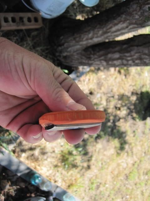

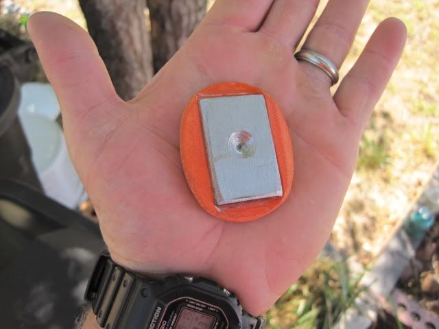

nice! i like that you even used orange paracord :) details on that orange hand socket?
JV3, Thanks,
The bearing I use is a piece of G-10 handle material that I cut our in that shape. then I glued a piece of 0-1 steel to it with a divit I drilled into the piece of steel. It is very friction free and works great. If you need more pics of it let me know.
Bryan

more pics would be nice. thanks!

JV3, I have a couple of pics for you of my home made bearing/hand socket.
Like I said I just cut a piece of G-10 handle material and made it oval shaped and then glued a piece of metal with a drilled in divit to the G-10 material. It can be done with many other pieces of material ie wood, bone, rock.
It is not to heavy or thick.
Hope the pics help and if you have any more questions just let me know.
