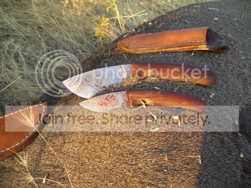

I have used as thin a 1/4" scales using hidden pins, and i do them all the time now.
This knife has 3 pins, 2 hidden and one visable.

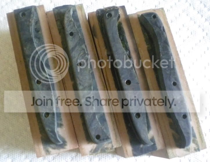

While obviously you want to make them as deep as you have room, you need to leave a little meat between the end of the hole and the outer surface of the part.
This is a relatively extreme example of it, the deepest hole is 1/8" deep, the shallowest is only 1/16". The pocket is square bottomed and the thread goes full form all the way to the bottom to maximize "bite".
and the finished hidden pin scales on the knife:
You can see why I didn't want pins showing in this particular piece.
I mill these threads, but I'm sure you could tap them with a bottoming tap followed by a tap modified with the end ground off so you could engage the full thread.
I have used them a couple of times, and have had no problems, one did have 2 visable pins and one hidden because of the planed schrimshaw to be done on the black buffalo horn.
