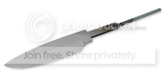

I wish someone with more hidden tang experience would jump in here. I’m talking as if I know soooo much about this, which I really don’t. Do you have a drawing of the blade with the tang that you could post? I’m having a hard time visualizing where you want to weld the tang to the blade. The picture below is a kit knife from Texas Knife supply. It shows how the tang and blade have been cut from the same piece of flat stock and the tang goes a couple of inches before a threaded rod is welded on.
What I’m trying to say (without any real personal experience to back it up) is that it seems to me that welding a tang straight to the blade rather than have it extend out as part of the blade, and as seen in the photo, could be problematic. If it is done before heat-treating how will the weld react to the extremes of heat and cold it will be subjected to by the process? If it is welded on AFTER heat-treating then there is the risk of compromising the entire heat treatment process. In both cases you have a weld joint that may or may not break depending upon the skill of the welder. In both cases I would think the welding process could develop internal stresses that may, or may not, affect the knife.
Keeping the weld point further away from where the tang joins the blade seems like a reasonable way of minimizing my imagined catastrophes.

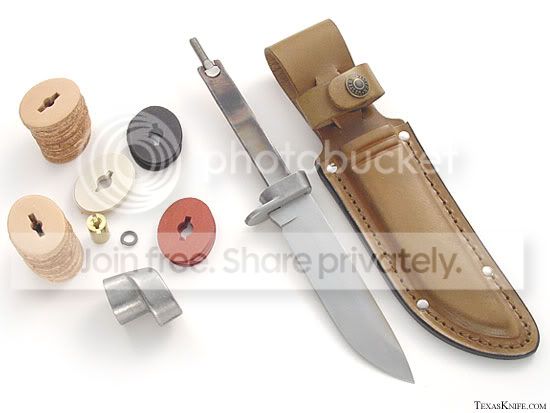

Here is another picture of a kit knife, again from Texas Knife Supply, similar to what you plan to make. Note how they are attaching a threaded rod to the tang without welding.

Nice links! Thank you. The second image is about what I have in mind. The only real difference is that there is a slight angle between the handle and the blade. Also, I was planning to leave as much metal near the choil as possible, making the blade part of the tang slope inward, instead of making it with straight edges. I only need about 1/2" of thread on the end.
I think I am going to go with brazing after the temper. I will put the blade in the vice with a big chunk of AL to absorb the heat on both sides. I know from doing other things that it will be OK. Then when I assemble the whole thing, I will use slow-cure epoxy to lock it all together.

Yeah brazing with brass is not as hot as welding and its a chemical bond rather than mechanical, I'm a newb to knife making but I tested it out and it dont break at the weld ever, if I bend the 1/4 bolt I'm using 3/4 times at 45 degree angle back and forth it will break about 1/4 to 1/2 inch from braised area on bolt side. When making a stacked leather handle I'd assume that your hardened tang needs to extend through almost whole length of handle like in the photo no 2, because leather needs rigid support otherwise your handle might bend under stress. Hope this helps
