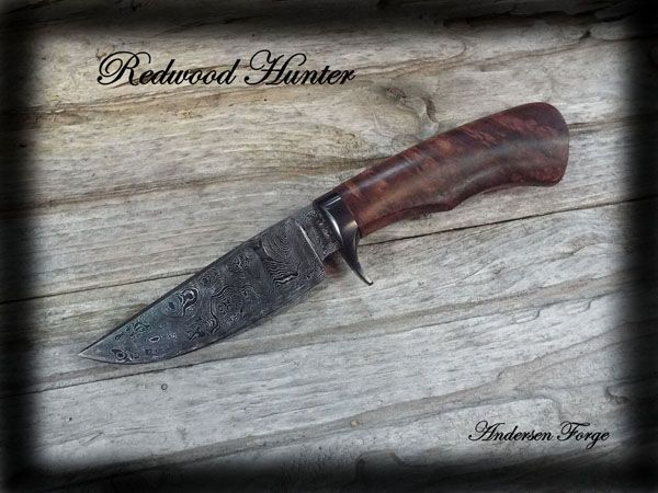

Here's my opinion on it.
I've got knives in all arenas of knife use around the world.
None have come back broken. At any place along the knife.
With one exception:
In all my years of knife making I've only had one come back with a broken tip, and that was a stainless blade, and the guy broke the tip off prying up ceramic tile. :eek:
I don't think the failure of a knife - whether it be blade, guard shoulders or tang - is a matter of being hard or soft.
I feel it's a matter of proper heat treatment, including grain reduction, hardening and tempering, and geometry.
I learned a rule - properly hardened and tempered MARTENSITE is far stronger than unhardened pearlite.
I want as much of my knife hardened and tempered as possible.
If I have to drill and tap and thread, I treat the knife accordingly to accommodate these procedures when the process dictates. That's why I mill my guard shoulders prior to heat treating. That area will more than likely be hard for the rest of it's life.
And keep in mind that the strength of the knife is not totally dictated by the shoulders, or the tang.
The guard and handle are part of the equation.
That's why I mentioned earlier about long length swords having hidden stick tangs.
Those wrapped and beautifully done handles ain't just pretty! The tang incorporates all of the components of handle as well for strength and transference of stress.
When you attempt to flex or 'bend' a knife by the handle, consider that the handle material - if in fact it is properly affixed to the assembly - must compress along one side.
I'm gonna cut this short - I have a shit load of work to do.
Put succinctly, if a tang is going to fail, it should first be necessary to completely destroy the handle and guard.
