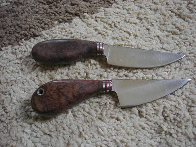

If your design of hidden tang handle is without pins it is possible to make it mortised and put a hidden pin in it. Like these I made:
I didn't want a pin on these, it would look terrible... But if you make your scales full flat and match the scale details it is pretty hard to see the joint of a mortised tang knife. When putting the pin it is important to know exactly how thick the handle will be, if you make it thinner you'll have a pin on the middle :)...
