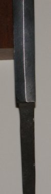

I believe you're referring to the junction between the tang and the main part of the blade. If the junction is squared-off it becomes a stress point. I have one HI blade, a WWII model by Sher kami, 19" overall length, that came with no handle, so the tang construction is visible. As you can see in the pics below, the junction is rounded off, though a bit crudely. The tang is also very thick where it meets the main blade, 5/16" in this case.

That tang is huge... thanks for the pics
