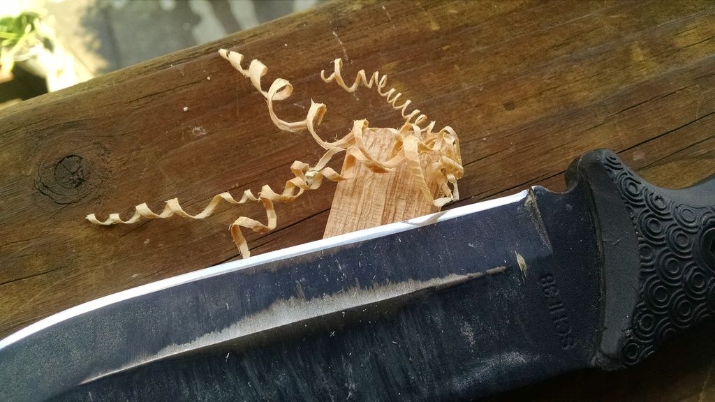

But its way cheaper. Just takes longer to sharpen and chips easy. I think I got one that wasn't properly annealed though.
Whatever, it works.
This edge took more time to grind on stones then my s30v bushcrafter
If your looking for cutting performance I'd save the cash and get a Becker or a RAT. If your on a tight budget and just want to beat on a blade the schrade works it just doesn't cut very well. Or Sharpen easy.
My 8cr13mov knife sharpens easier and takes a great edge. It can't hold it though and after batoning or carving a few feathersticks it has glints seen in the edge and Is noticeably dulled.
These knives are still great for $30. You'd have to go out of your way to really break them. Some people are insane hard on there knives. For me , I just can't stand the lack in cutting performance. I think for the average guy who throws his stuff around they work great
