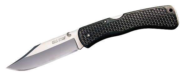

Cold Steel Voyager is a decent, dependable knife with a
blade length of almost three inches. Price: $40+-
