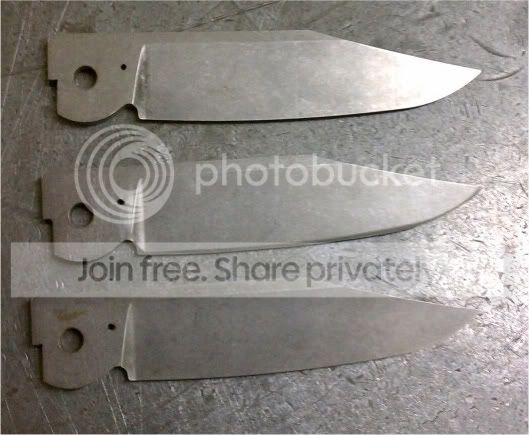

I made these three out of Vanadis 10. (.8 More Vanadium than S110V)

They are Wire EDM. I cheated. The stuff was already hard.
Carl, was it round before Wire EDM cutting? I couldn't find flat Vanadis 10 bars. Can you tell us where you ordered Vanadis 10? Have you tested it? If yes, what are your impressions?
