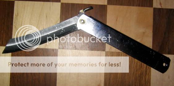

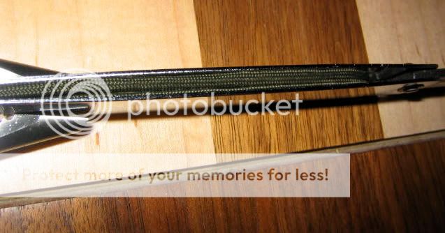

i've been using these knives and have been very impressed. the one thing i didn't like was how the blade edge contacts the handle in the closed position. i thought about gluing in a piece of wood or leather, but i wanted to use something that could be replaced if it wore down. i took a piece of paracord, and "mushroomed" the ends to keep it in place. it has worked very well so far, and these are the sharpest out the box knives i own.

i read the post about squeezing the handles on this forum - and it definitely works. i just liked the idea of having an extra shock-absorber in there in case i dropped it.
