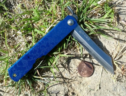

Here are the specs on my "80mm" Higonokami if it helps any:
Blade thickness: 3mm
Blade grind: Scandi/Saber with secondary microbevel
Blade length: 73mm (blade is supposed to be 80mm)
Handle length: 97mm
Closed length: 108mm
Weight: ~2oz (rough estimate)
Warikomi basically just means laminated steel, which the Blue Steel (Aogami #2; NOT Super Blue) is. Here's some info on Blue #2, but not sure how helpful it will be: http://zknives.com/knives/kitchen/misc/articles/kkchoser/kksteelp3.shtml
