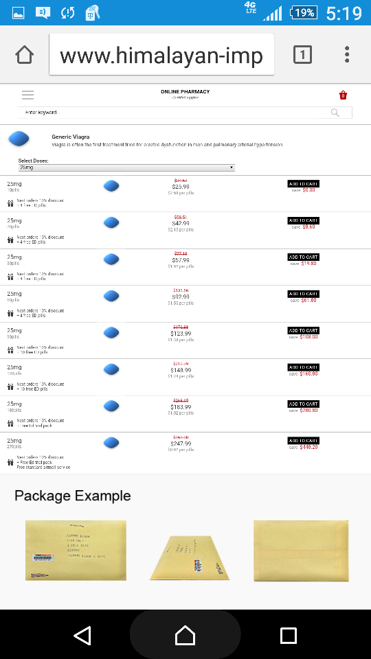

Hey,
When searching on google, I get this message:
"Himalayan Imports / BirGorkha Khukuri (Nepal)
www.himalayan-imports.com/
This site may be hacked.
Hand-forged khukuris, the knives of the Gurkhas, in a variety of traditional and modern patterns."
I ended up clicking on the site by mistake and I was sent to a strange chinese site instead that seemed to be about exchange rates and money. I can't be the only one? It seems the site was either hacked or there's a serious DNS direction problem with the host.

Edit: Interesting. I can still browse the site just fine here. But if I do a google search, get the same message and redirect to an online pharmacy. If I do a DuckDuckGo.com search, I click through just fine. So this might be a google hack or Google is just the first to propagate it.
Edit2: Bing searches are messed up also.

typing the URL into my browser brings the real website, going through google.... dick pills.
Google search for "Himalayan Imports":
Only the "Khukuris, page 1" and "Gurkhas" links connect to the real HI website. The top link and all the middle links are to the Chinese pharmaspammer's site. :mad:

It's a strange situation. As far as I can tell (without exhaustive testing) the HI web site itself is ok. The problem only occurs when you use a URL obtained from a search engine (Google, Bing and maybe some others). Also, if you copy the link from the search engine and paste it into a browser window, it takes you to the correct HI web site.
There is something called the "Google Redirect Virus" that is apparently widespread (not new) and might be causing this. If that's the case, we would expect that some people on this forum will not experience the symptoms, since it is unlikely that all of us are infected.
Is there anybody on the forum who gets the correct HI link when you do a Google search for "Himalayan Imports" and click on the link?
Probably not a virus but an actual hack, more information on this type of behavior here:
Removed the link as it is setting off virus warnings itself.
